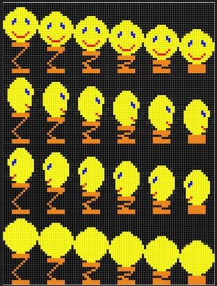

I made a simple animation that I did in Paint.NET.
Try it out and give comments on how it can be improved.
I might be programming completely wrongly or unnecessarily.
Change the program and give suggestions on how it can be written instead.
jump-v3.zip
(using PicoMite MMBasic)
/Peter63

I have increased from 6 sprites to 24 sprites. Front, Right, Left, Back - sprite.
To get a bit more realistic movement.
new version program
jump-v5.zip
/Peter63

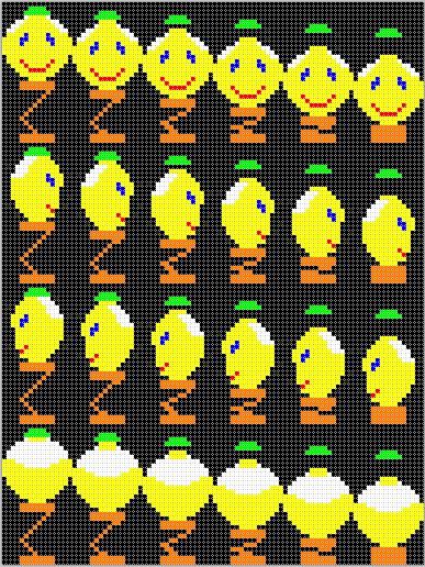

a little hair and a little hat, version 9
jump-v9.zip
/Peter63

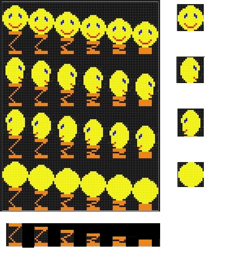

Just a quick tip for optimisation
A large proportion of your sprites are identical, so if you split your sprites into two elements, you can save quite a lot of memory.
Horizontally, the face remains the same; vertically, the spring.
That way, 10 sprites would be enough for everything; if you mirror the left/right face, you’d only need 9
Edited 2026-04-20 00:34 by Martin H.
