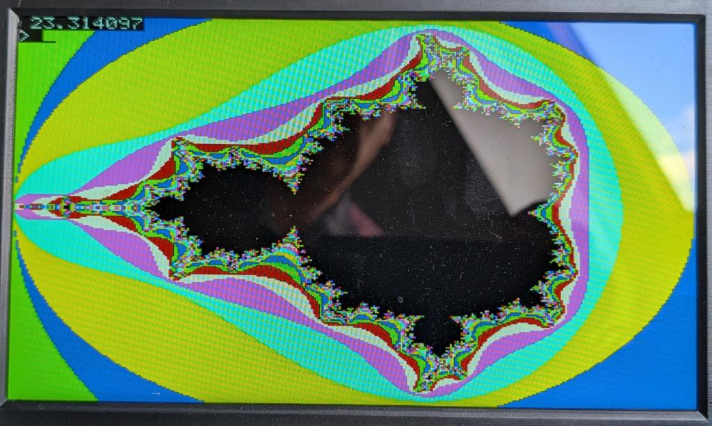

Here is a test program

On a HDMIUSB system with OPTION RESOLUTION 640,378000 set this takes 42.4 seconds
However, add the magic line at the top
Option tracecache on
and.....

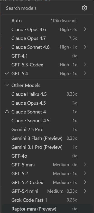

  matherp said  built in increments using Claude 4.7 - very expensive to use but largely infallible in terms of each step meeting the brief and working first try.
How expensive is "very expensive"? I spent about $5USD a day for 5 days to work out some deep bugs--fairly intensive use, but far from "all day, every day". Expensive for a retired person doing it for recreation, but not for paid development.
Since that stretch I've managed lighter use on the monthly subscription--several times hitting a period limit and then doing other things for several hours until the next period rolled around.
Edited 2026-04-20 00:35 by lizby
Posts: 12174
Posted: 04:06pm 19 Apr 2026
  Quote  How expensive is "very expensive"?
USD26 in a day
Posted: 04:17pm 19 Apr 2026
Wow. We should take up a collection for you. As if your time wasn't already of nearly inestimable value. I would be more than happy to contribute to a GoFundMe.
I understand and appreciate your insistence on not getting paid for the MMBasic development you do, but we could at least help to cover actual expenses at this scale.
