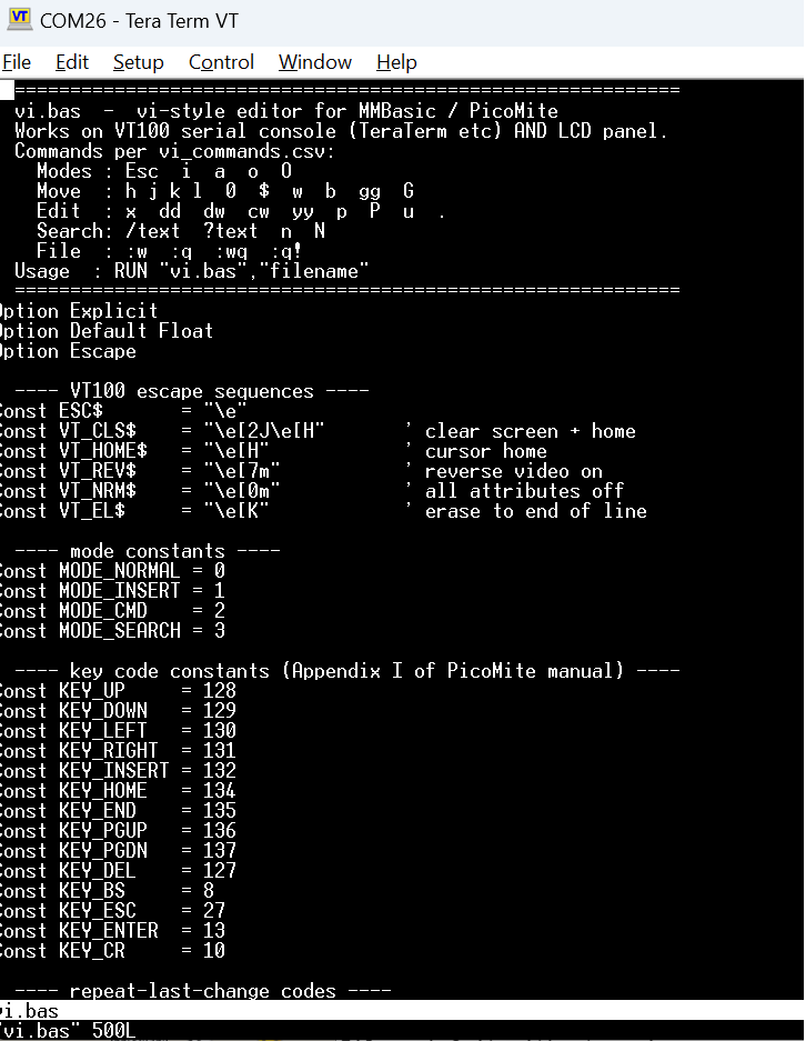

Posted: 05:52pm 17 Apr 2026
Filed under "Just As a Lark".
  Volhout said  P.S. there are forum members that use AI to write MMBasic code. I assume that with perseverance you could get the editor you want (i.e. VI ?  ) in MMBasic code.
That sounded like a challenge (I don't think it was meant to be). After about 10 minutes to perplexity to give me a (perhaps simplified) vi cheat sheet in csv form, I uploaded the cheat sheet to Claude along with the Picomite manual, and gave this prompt:
  Quote  In MMBasic, please produce a vi-type editor implementing the commands in the uploaded file. Confirm that program syntax is as documented in the MMBasic Picomite manual. Take as much time as needed to be thorough and accurate. Do not use LOCAL within DO or FOR loops.
I started it with run "vi.bas" "vi.bas" (to edit itself). The first pass failed because it wanted to use CALL subsomething() instead of just subsomething(); then failed because I was using TeraTerm, not a display, then failed because of a trivial mistake (VAL used on an mm.info return which was already a number). Then it displays correctly including scrolling to a new page. I haven't tested any commands (because I hate vi). 1100+ lines of code provided while I was doing other things.

Hi Lizby,
I have always used Vi and your version is working :-)
There was a variable "Pos" which I had to change to "Posi" as it's a command.
But basically it works, If you wouldn't mind giving your Ai some more work, there is one important feature that is missing.
If you put a number before any "Move" Or "Edit" command, that command is repeated the number of times specified. So.
7yy will yank(copy) the next 7 lines into the buffer or
8dd will delete the next 8 lines into the buffer
and yes
5p will put(copy back) the yanked buffer to the cursor 5 times, etc...
Also I almost exclusively don't use a terminal, so haveing either two versions, one screen one terminal, or a single version that can be simply, with a flag, swapped between the two modes, would be fantastic. :-) Currenntly on a HDMI or LCD screen I get the file text, but with control/escape code everywhere. :-(
Regards Kevin.

I also took a look at the AI-generated source code for "vi" in MMBasic:
' ---- buffer limits ----
Const MAX_LINES   = 300
Const MAX_LINELEN = 150
' ---- text buffer ----
Dim buf$(MAX_LINES) Length MAX_LINELEN
This is roughly what I expected from AI without detailed algorithm specifications: It's first-year programming!
On average, about 80-90% of RAM is wasted with only 300 lines of capacity and a 45kB requirement.
A properly programmed editor uses RAM efficiently and, when RAM is limited, only keeps a portion of the current text in RAM and the rest in a temporary file, thus enabling it to process texts of virtually unlimited size. This already worked on the Z80 under CP/M.
