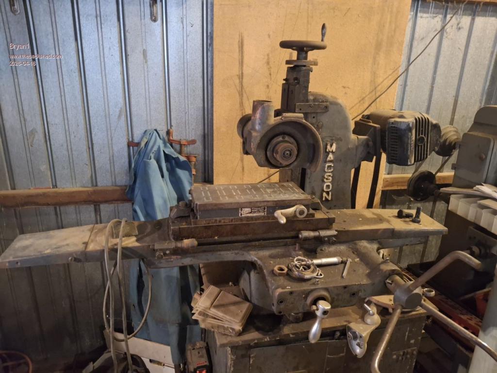

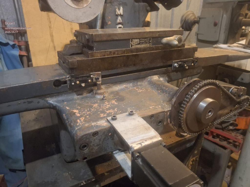

Ok Guy's the whole point of this project is to make a state machine so I can run my old Macson surface grinder.
Now the inherent problem is with the Z axis on this machine where the lead screw has a heap of backlash and when setting the grinding wheel doing 2,000 RPM it tends to jump and I have already broken a grinding wheel trying to use this machine.
This is where a ball screw can come into play for the Z axis so if needed a step by step can set the cut then the DRO on the screen can be set to zero where the predetermined cut is done.
I do have a 2 pole 3 phase motor for this project and a Delta VFD so the motor can run off single phase and the best part the Delta VFD does have a serial interface where the hertz can be changed so the speed once calibrated can be dialed in using the G-code.
Now the X axis rack and pinion drive and as it's only going back and forth I can machine the stepper mount off the original handle and fabricate up the securing mount for the stepper motor.
The Y axis in operation is going to increment in steps every forward pass depending on the width of the grinding wheel.

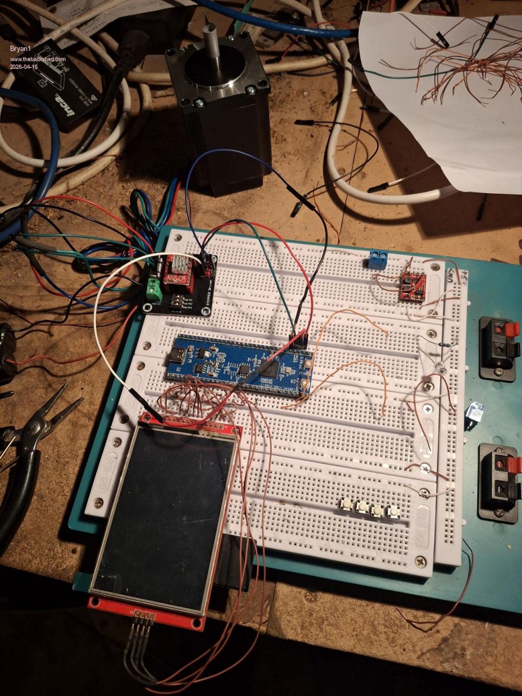

Now here is a pic of my test setup
For now the 3.5" touch screen can do while the code is built up and as there are so many spare pins I do think a 9" touchscreen in 16 bit mode as reading in the manual today 16 bit can be done. I do need to order more dupoint cables for this project so no rush as I have been thinking about this project for a long time.
Regards Bryan

Yeah that backlash needs fixed. No fun busting a grinding wheel
Those VFDs are fun, fun, fun
I fitted one to an old Bridgeport knee mill and it runs beautifully. The original fwd/rev selector failed and it was £70 for a replacement. This was a good opportunity to try eliminating it altogether. The VFD + remote pendant was < £50.
No need to mess with the belt/pulleys to change speeds now.
Mine also has the serial interface but I prefer the external 0 to 10V analogue and fwd/rev-select option.
It seems that most of these units have the option of VFD/Vector (FOC) modes. The Vector mode runs quieter.
Pretty sure I could close the loop on this thing with encoder feedback to the PicoMite. It would be a bit of a dog compared to a true servo, due to the high rotor inertia and for continuous operation, I would need inverter-rated windings but there are many applications that are not so demanding.
On two occasions over the past year, I have been called-out to a dead production line due to a failed motor starter. One was DOL and the other was star/delta. I didn't have time to order VFDs but I could've installed TWO (one as a spare) for similar cost.

There is a version of that surface grinder in the shed here, we fitted a pneumatic cylinder under the grinder spindle head that takes the weight and backlash out of the leadscrew, a cheap regulator sets the pressure accordingly. Works so much better now
Good luck.
Lyle.
PhenixRising
Joined: 07/11/2023
Posts: 2149
Posted: 03:17pm 16 Apr 2026
  mozzie said  a pneumatic cylinder under the grinder spindle head that takes the weight and backlash out of the leadscrew
Used these for a similar application

As this surface grinder is fully manual my idea of automating it does make sense so the grinder is more efficient.
Now going a damper on the Z axis could work but I already have a ball screw that is suitable to fit. I got this off an old Hercus cnc lathe and length wise it will fit easily.
