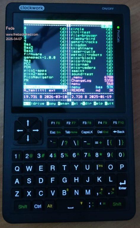

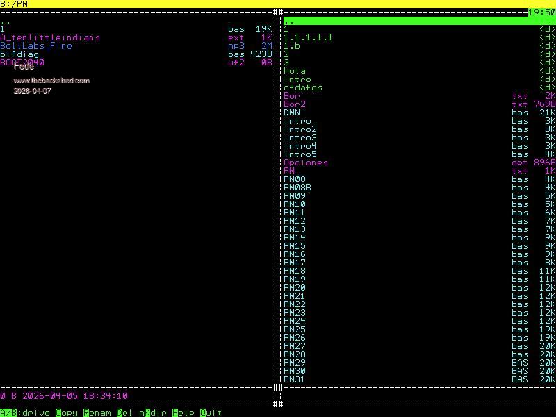

I present to you my 'Pico Navigatto'. A File Manager in MMBasic for PicoMite.
I have tested it on PicoCalc and on my PicoMite RP2350 VGA.

The bottom line of the screen displays: Size, date, and time, or whatever fits.
I tried to make it display more or less information depending on the number of characters on the screen. But when I added the date and time fields, the program became too slow.
This is my fault because the program reads from the disk very frequently to update itself.
The same thing happens when the number of files increases considerably. I have a folder with more than 100 files, and it's starting to become very noticeable.

A really nice file manager. Runs flawlessly on my PicoCalc. I’ve placed it in drive A: and assigned it to the F1 function key. That way, it’s always right at your fingertips. The different text sizes are also great. It would be even better if it included a .txt viewer and an MP3/WAV player. Well done!

  PilotPirx said  A really nice file manager. Runs flawlessly on my PicoCalc. I’ve placed it in drive A: and assigned it to the F1 function key. That way, it’s always right at your fingertips. The different text sizes are also great. It would be even better if it included a .txt viewer and an MP3/WAV player. Well done!
Thank you so much.
I loved your comment.
The MP3 player will take some time, as I don't see it in a file manager.
But I've done two out of three.
Best regards.
