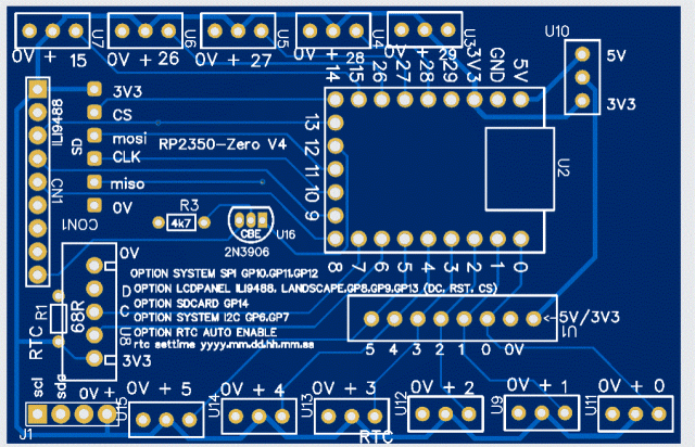

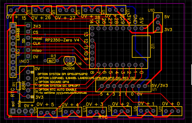

RTC module, SD card module, ILI9341 or ILI9488 (no touch), I2C, 10 pins broken out to 3-pin headers, one 6-pin port alternatively using pins 0-5 with GND and optional 3V3 or 5V power.
An earlier version of this was the first one I've had where the 680 resistor failed to keep the ILI9488 MISO signal from fouling the SD card. So I used a 2N3906 PNP transistor to gate the MISO signal with *CS.
Gerbers are attached. JLCPCB shipping to the U.S. went up from about $3.30 2 weeks ago to $6.60 now. Still, 5 pcbs for under $2 each is quite a bargain compaired to what I paid a dozen years ago.

Thanks, Phil. I had seen your post about the diode (also got the transistor idea from you--why might it not work?), but it didn't really register. I don't have touch wired here, so no signal to T_DO.
