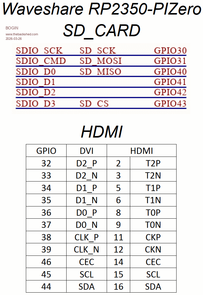

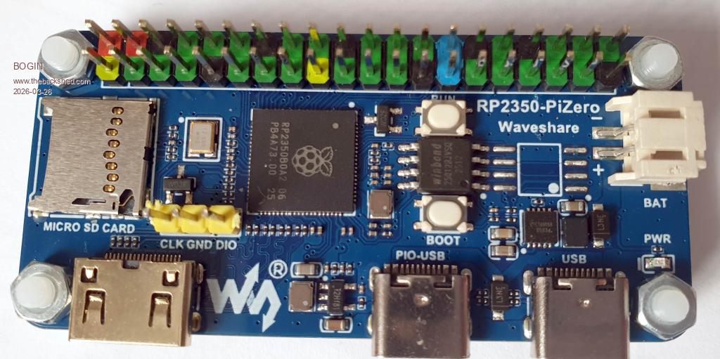

I have two Waveshare RP23450B modules. Can I use the HDMI connector on this module with the PicoMite?

No, the PicoMite firmware uses the HSTX peripheral for DVI/HDMI and that is only available on gp12-gp19

Looking at the schematic of the Waveshare RP2350-PIZero they just seem to bring the HSTX pins out to a (non-DVI/HDMI) connector... why not use them for their designed function and bring other GPIOs out?  I suppose I'm missing something but it seems daft.

It's a silly design. This sort of module is ideal for embedded computing, which the HSTX would be useful for - it doesn't have to be for generating HDMI, it's a very fast 8-bit parallel transmission port. Unless the pinouts are Raspberry Pi compatible and that's how they worked out? I haven't looked.
