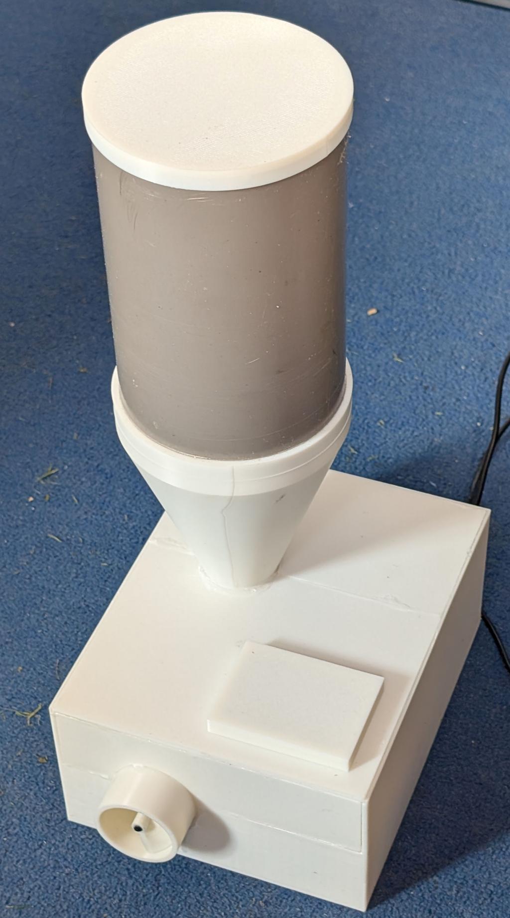

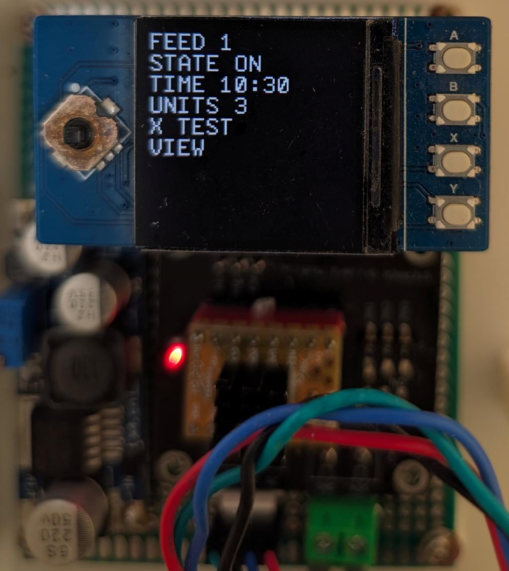

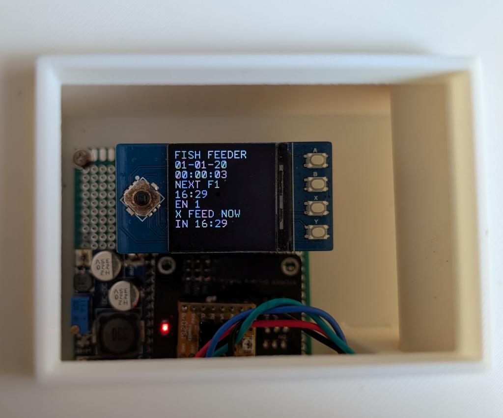

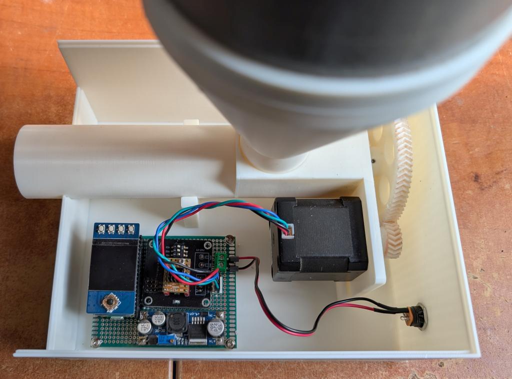

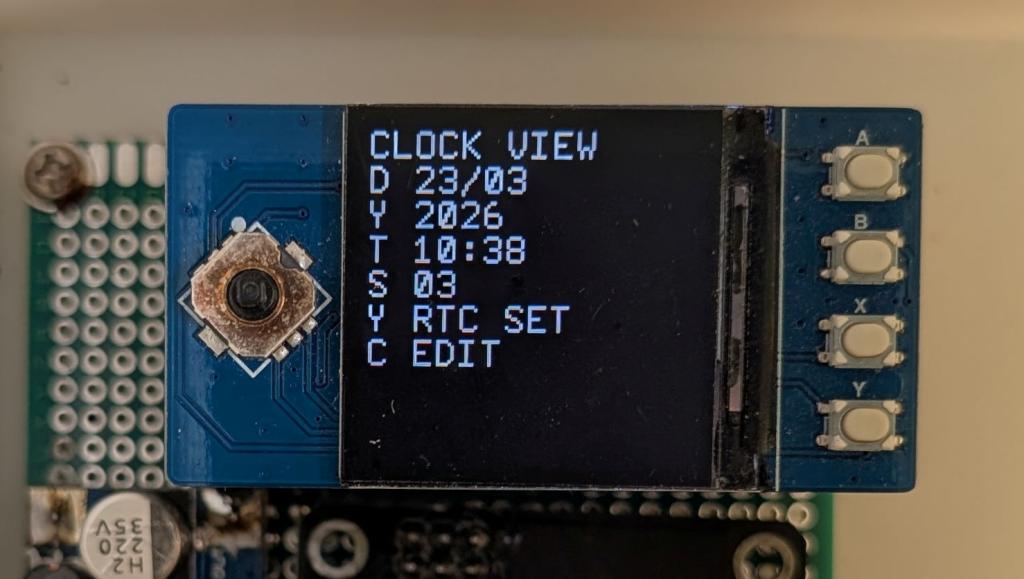

Pico2 + Waveshare RTC + Pico-LCD-1.3 + Stepper driver module + TMC2209 driver

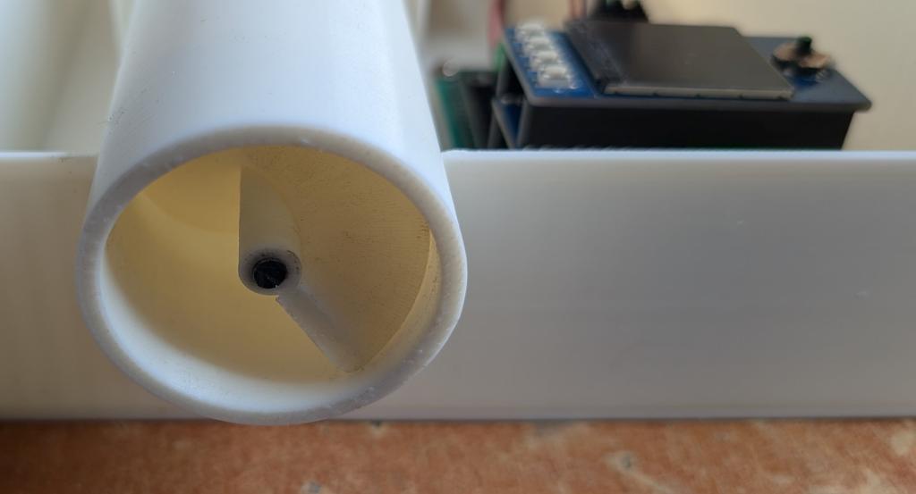

Everything 3D printed. STLs available if anyone wants them. Uses archimedian screw to deliver the food.
Runs with a CPU speed of 48MHz which results in a current draw of about 25mA at 12V so an old car battery should run it for a month easily.
option list
PicoMite MMBasic RP2350A V6.02.01RC8
OPTION SYSTEM SPI GP10,GP11,GP28
OPTION SYSTEM I2C GP6,GP7
OPTION AUTORUN  ON
OPTION FLASH SIZE 4194304
OPTION COLOURCODE ON
OPTION CPUSPEED (KHz) 48000
OPTION DISPLAY 64, 132
OPTION LCDPANEL ST7789, LANDSCAPE,GP8,GP12,GP9,GP13
' FishFeeder.bas

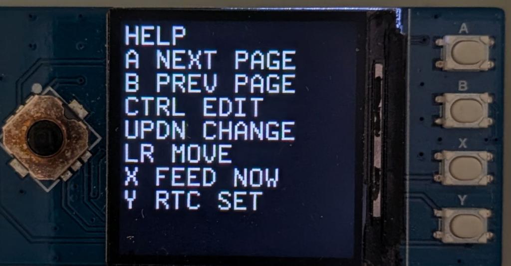

' Automated fish feeder UI for PicoMite (240x240 display + buttons/joystick)
' Navigation:
' A = next page, B = previous page
' CTRL = toggle edit mode on current page
' UP/DOWN = change selected field/value in edit mode
' LEFT/RIGHT = move field selection in edit mode
' X = manual feed now (from HOME page)
' Y = force RTC SETTIME (from CLOCK page)

Sub DrawHelp
 Text 4, 4, "HELP"
 Text 4, 28, "A NEXT PAGE"
 Text 4, 52, "B PREV PAGE"
 Text 4, 76, "CTRL EDIT"
 Text 4, 100, "UPDN CHANGE"
 Text 4, 124, "LR MOVE"
 Text 4, 148, "X FEED NOW"
 Text 4, 172, "Y RTC SET"
End Sub
Sub DrawPrime
 Text 4, 4, "PRIME"
 Text 4, 28, "HOLD X RUN"
 Text 4, 52, "REL X STOP"
 Text 4, 76, "CONT MOVE"
 Text 4, 100, "A/B PAGE"
End Sub
Sub DrawHome
 Local nexti%, i%, nowMins%, fm%, m%, t$
 Local dMins%, cH%, cM%
 t$ = Time$
 nowMins% = Val(Mid$(t$, 1, 2)) * 60 + Val(Mid$(t$, 4, 2))
 nexti% = 1
 fm% = 24 * 60 + 1
 For i% = 1 To FEED_MAX
   If feedEnabled%(i%) Then
     m% = feedHour%(i%) * 60 + feedMin%(i%)
     If m% >= nowMins% And m% < fm% Then
       fm% = m%
       nexti% = i%
     End If
   End If
 Next i%
 If fm% = 24 * 60 + 1 Then
       fm% = feedHour%(i%) * 60 + feedMin%(i%)
       nexti% = i%
       Exit For
     End If
   Next i%
 End If
 Text 4, 4, "FISH FEEDER"
 Text 4, 28, Left$(Date$, 8)
 Text 4, 52, Left$(Time$, 8)
 Text 4, 76, "NEXT F" + Trim$(Str$(nexti%))
   Text 4, 100, "--:--"
   Text 4, 172, "IN --:--"
 Else
   Text 4, 100, TwoDigit$(feedHour%(nexti%)) + ":" + TwoDigit$(feedMin%(nexti%))
   dMins% = fm% - nowMins%
   If dMins% < 0 Then dMins% = dMins% + (24 * 60)
   cH% = dMins% \ 60
   cM% = dMins% Mod 60
   Text 4, 172, "IN " + TwoDigit$(cH%) + ":" + TwoDigit$(cM%)
 End If
 Text 4, 124, "EN " + Trim$(Str$(EnabledCount%()))
End Sub
Sub DrawClock
 Local m$, markX%
 markX% = 240 - (3 * MM.FONTWIDTH)
 If editMode% Then
   m$ = "EDIT"
 Else
   m$ = "VIEW"
 End If
 Text 4, 4, "CLOCK " + m$
 Text 4, 28, "D " + TwoDigit$(setDay%) + "/" + TwoDigit$(setMonth%)
 Text 4, 52, "Y " + Trim$(Str$(setYear%))
 Text 4, 76, "T " + TwoDigit$(setHour%) + ":" + TwoDigit$(setMin%)
 Text 4, 100, "S " + TwoDigit$(setSec%)
 Text 4, 124, "Y RTC SET"
 Text 4, 148, "C EDIT"
 If editMode% Then
   Select Case fieldSel%
     Case 0: Text markX%, 28, "<D"
     Case 1: Text markX%, 28, "<M"
     Case 2: Text markX%, 52, "<Y"
     Case 3: Text markX%, 76, "<H"
     Case 4: Text markX%, 76, "<N"
     Case 5: Text markX%, 100, "<S"
   End Select
 End If
End Sub
Sub DrawFeed(idx%)
 Local m$, en$, markX%
 If feedEnabled%(idx%) Then
   en$ = "ON"
 Else
   en$ = "OFF"
 End If
 If editMode% Then
   m$ = "EDIT"
 Else
   m$ = "VIEW"
 End If
 Text 4, 4, "FEED " + Trim$(Str$(idx%))
 Text 4, 28, "STATE " + en$
 Text 4, 52, "TIME " + TwoDigit$(feedHour%(idx%)) + ":" + TwoDigit$(feedMin%(idx%))
 Text 4, 76, "UNITS " + Trim$(Str$(feedUnits%(idx%)))
 Text 4, 100, "X TEST"
 Text 4, 124, m$
 If editMode% Then
     Case 0: Text markX%, 28, "<E"
     Case 1: Text markX%, 52, "<H"
     Case 2: Text markX%, 52, "<M"
     Case 3: Text markX%, 76, "<U"
   End Select
 End If
End Sub

circuit
Joined: 10/01/2016
Posts: 309
Posted: 09:21pm 22 Mar 2026
Wonderful and really nicely engineered; I especially liked the "Citroen-style" herringbone gear system.  Just typical of Peter to use a complex (but appropriate) gear system instead of straight gears.  Lucky fish!
Posts: 3381
Posted: 10:38pm 23 Mar 2026
Click the "Stepper Driver" link on the first line of this thread, then click view details.
  Quote  Description
Name: 4988/8825 stepper motor drive module expansion board
Fixed: 3mm
Hole distance: 1400*1400mil (35.56*35.56mm)
Logic voltage: 5V
Input voltage: 12-30V
Port: Number
Interface: direction, enable, speed
Applicable modules: A4988, DRV8825
Note: Please pay attention to the direction when installing the driver module, otherwise the module will be burnt
This product is only an expansion board, does not include 4988/8825 drive modules
Looking at Peter's first photo a "Drive Module" is plugged into the top of that.
Another seller says:-
  Quote  Description
2 CH Stepper Motor Driver Expansion Board Stepper Drivers Module Modular DRV8825/A4988 for UNO R3 3D Printer
Feature:
On-board DIP switch, you can easily adjust the drive segments
Terminal power connector for easy connection drive power
Compatible with 12 / 24V drive scheme
Suitable for 42 stepper motor drive, for 3D printers and DIY
Specification:
Size: 42 x 42 x 15mm
Fixed: 3mm
Pitch: 1400 x 1400mil (35.56 x 35.56mm)
Logic voltage: 5V
Ports: Digital
Interface: Direction, enable, speed
Applicable module: A4988, DRV8825
Note: Please note the direction when installing the drive module, otherwise it will burn module
Package includes:
1 x 42 Stepper Motor Drive Expansion Board
And for the A4988 module to plug into it:-
  Quote  Description
report
Warm prompt: Dear buyer, Our cheapest transportation services Economic category logistics (SunYou Economic Air Mail ,China Post Ordinary Small Packet Plus ) can be traced only befor it arrive your country,please choose Standard category logistics if you want a full tracking info.
Brief introduction
A4988 is a complete microstepping motor driver with built-in translator for easy operation. This product is available in full, half, 1/4, 1/8 and 1/16 step modes operate bipolar stepper motors, output drive capacity of up to 35 V and ± 2 A. A4988 includes a fixed off-time current regulator, the regulator in slow or mixed decay modes. A4988 converter is the key to the easy implementation. As long as the "step" input inputting one pulse drives the motor one microstep. There are no phase sequence tables, high frequency control lines, or complex interfaces to program. A4988 interface is very suitable for complex microprocessor is unavailable or is overburdened.
In the micro-step operation, A4988 chopping control inside automatically selects the current decay mode (Slow or Mixed). In mixed decay mode, the device is initially set to a fixed downtime in some fast decay, then the rest of the slow decay downtime. Mixed decay current control scheme results in reduced audible motor noise, increased step accuracy, and reduced power consumption. Internal synchronous rectification control circuitry is provided to improve the pulse-width modulation (PWM) operation power consumption. Internal circuit protection includes: thermal shutdown with hysteresis, undervoltage lockout (UVLO), and crossover-current protection. Special power sequencing.
A4988 surface mount QFN package (ES), a size of 5 mm × 5 mm, nominal overall package height of 0.90 mm, with an exposed pad for enhanced thermal dissipation. This package is Pb (suffix-T), with 100% matte tin leadframe plating.
Features and Benefits
· Low RDS (On) Output · Automatic current decay mode detection / selection · Mix with slow current decay modes · Synchronous rectification for low power dissipation · Internal UVLO · Cross-current protection · 3.3 and 5 V compatible logic supply · Thermal shutdown circuitry · Ground fault protection · Load short-circuit protection · Optional step five modes: full, 1/2, 1/4, 1/8 and 1/16
dddns
Joined: 20/09/2024
Posts: 910
Posted: 10:48pm 23 Mar 2026
Bigtree has nice drivers
