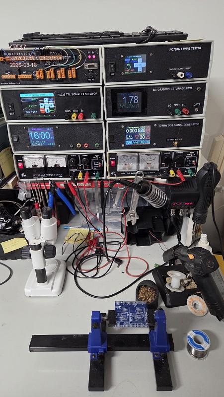

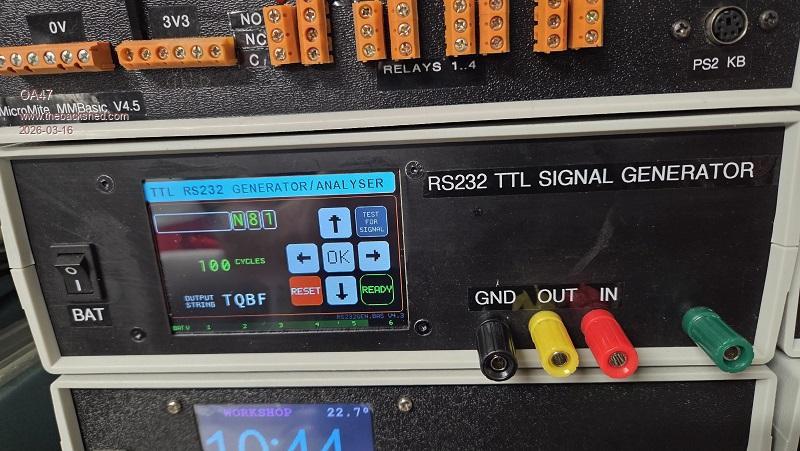

  Quote  That's a nice looking unit you have there, along with all the rest
This is the home grown test gear I have put together over the years. Some Pi Pico, some Micromites, some Armmites and all get a bit of software updates as time goes on.
