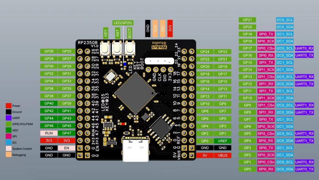

I found the WeAct rp2350b core module that had pads for PSRAM are not all wired in. I chased my tail on this one for days. Out of ideas , I stacked it on the flash with the cs line still going to gp47. Worked first time. Now frankos partially works. There are a few apps on the MOS2 directory that work ok. Stephans basic runs and a few utility programs are ok (the psram app verifies my memory is ok).Still no mmbasic. All programs in the FOS directory freeze and then reboot the machine. I was about to give up , I will try a bit more now.
Posts: 3881
Posted: 11:34pm 20 Mar 2026
  gadgetjack said  I found the WeAct rp2350b core module that had pads for PSRAM are not all wired in
If you're talking about the one above, I've soldered PSRAM on two of them and they're working fine.

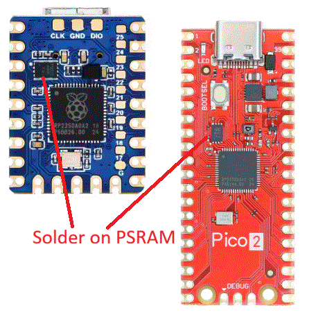

  gadgetjack said  PSRAM ... I stacked it on the flash with the cs line still going to gp47.
Does this mean you can do it with essentially any RP2350 board? Like this?
With CS lifted and wired to GP0?

@Javavi showed it first
Posts: 9136
Posted: 12:21pm 22 Mar 2026
Well, it's possible because it's been done. It's fiddly though. Personally I prefer to just use a PGA2350 because it's much easier. :)
