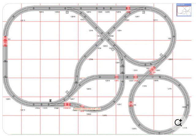

I wanted an application to exercise and test PicoDB . About 8 weeks ago, someone mentioned an interest in model railroad control. After I finished PicoDB, I thought that might be just the ticket. I had an HO gauge layout when I was a teenager, but have hardly given a thought to it in 60 years.
I started work on it with Gemini on February 14. The exercise has been a success--the virtual model train works, and PicoDB serves it (and we found and fixed 4 obscure bugs in PicoDB).

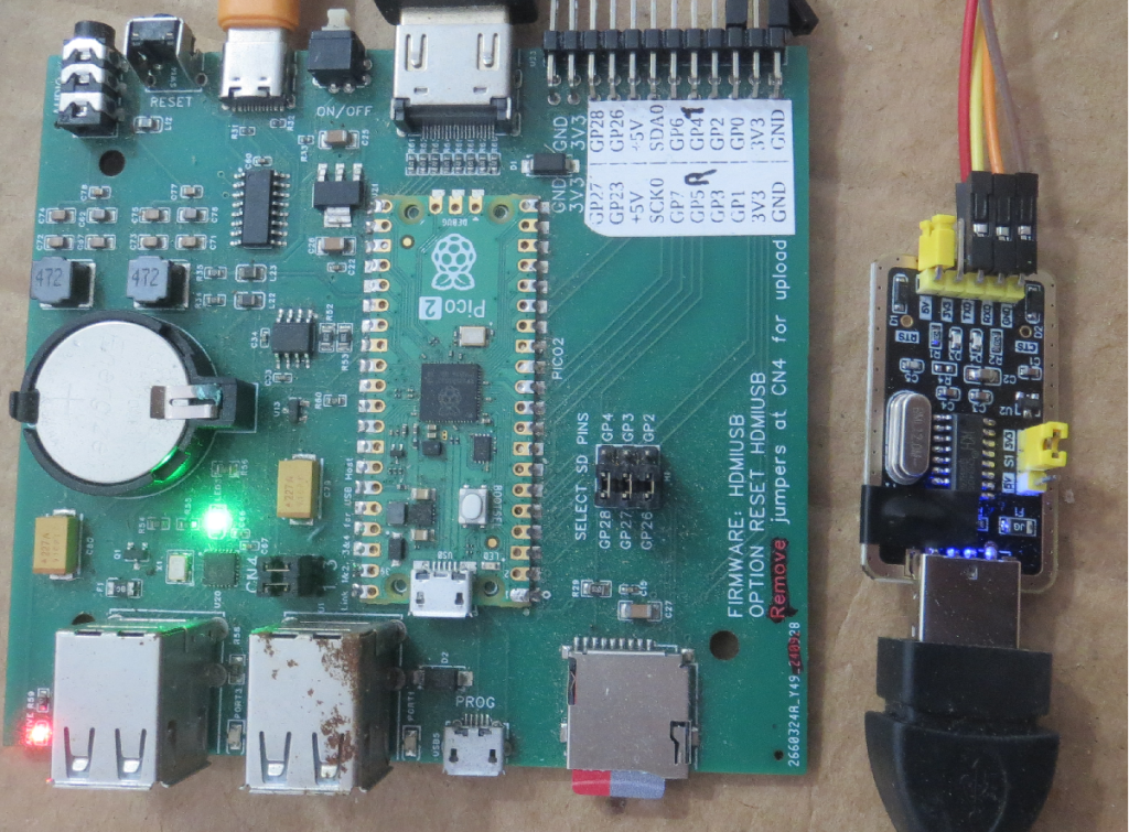

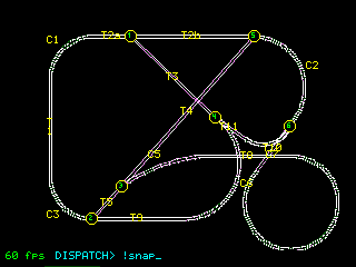

This is running on Peter's Pico2 HDMI PCB:
You drive the trains by typing commands (on PC/laptop keyboard--I don't have a keyboard attached to the PCB) at the "DISPATCH>" prompt on the Screen/LCD. For instance, s6+ve1 20 will flip switch 6 out of spur2 and start up the train behind Engine E1.
Here's the quick help ("?" at the "DISPATCH>" prompt) for dispatch commands at the keyboard.

!SNAP [name]    : Save a screenshot to the SD card. Defaults to l.bmp.
                 Ex: !SNAP yard.bmp
!LAYOUT [#]     : Hot-swap the track geometry to Layout #.
                 Ex: !LAYOUT 3

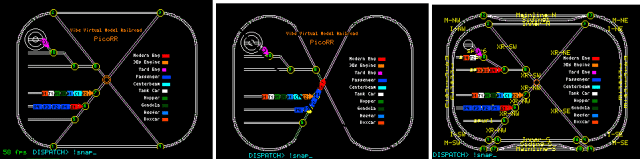

There are 3 layouts available at present:
Fuller documentation is in the zip file, which contains everything needed to run on a Pico2 HDMI, 640x480 Mode 3. I think it will work with VGA, but haven't located the boards I know I have somewhere. I have it displaying, but not yet running, on LCD 320x240 and 480x320.

Last night I asked Gemini to start to implement sprites instead of drawing all those boxes (and then the tracks underneath them when the cars moved)--all as an option in addition to the existing features. Car and engine sprites were just to be circles, which made placement easy. The mode was to be set/reset with !sprites.
I thought this might take some time (days?), but in a few hours, it was to the point of just needing tweaks. Speed jumped from 1-2 frames per second (which was good enough) to 6-7fps with engines E1 and E2 moving with cars. This morning, all settled and here's the video:
PicoRR with sprites
This is the script its running:
!show c,!sprites
s6+s3+s15+s11+ve1 20
at e1 Mainline-W
s7+s6-ve2 15,sv+s1+s2+s4+
at e2 Inner-E
s15-s11-s7-
Updated PicoRR V2 (Library and related files unchanged):
PicoRR V2.zip

I just found Mick's PicoStick VGA (for which I ordered the PCBs from JLCPCB on July 22,  2022) put a Pico2 in it and flashed the latest, downloaded all the PicoDB and PicoRR files, and it runs with no changes.
Posts: 9328
Posted: 08:24am 11 Mar 2026
A blast from the past. :)
I bet that makes a nice little unit now, it's not one that I ever built :) .
The Pico 2 is a definite upgrade. Would it be worth thinking about a VGA222 version?
EDIT:
I'm almost certain that it's possible to build it for VGA222 if you don't mind soldering 1206 resistors.  :)  I have an almost complete design now.
GP14 was spare, is now the LED data pin.
GP15/GP16 work out well for the synchs
GP17-GP22 are right for the video.
GP22 was only on an expansion port.
Edited 2026-03-11 21:00 by Mixtel90
Posted: 01:06pm 11 Mar 2026
  Mixtel90 said  a nice little unit now
Yes, indeed. It is so small it was easy for me to lose ;-/
RGB222 would be awesome with this 40-pin Pico2 with 16MB PSRAM ($5.96 each for 2 with free shipping):
RP2350A 16MB PSRAM
Posts: 9328
Posted: 02:23pm 11 Mar 2026
It doesn't actually say it has PSRAM. It says 8M or 16M flash.
There's no schematic either.
The Pimoroni Pico Plus 2 should work, in theory. It costs a lot more though. It'a RP2350B based.
Edited 2026-03-12 00:53 by Mixtel90
Posted: 03:23pm 11 Mar 2026
Oops. Anyone see a standard-size 40-pin RP2350A board with PSRAM?

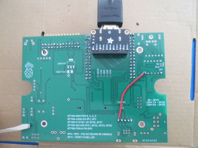

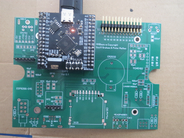

PicoRR works with Mick's GAP2V1 HDMI/DVI PCB for the WeAct RP2350B module with the Adafruit DVI Breakout module (There's now a GAP2V2 )
The PCBs from JLCPCB arrived yesterday afternoon. I soldered sockets and plugged in a working WeAct module. No joy and no voltage on the modules 3V3 pin. I PMed Mick and he said the layout was designed for the regulator, and the EN pin on the WeAct was tied to GND. I snipped off the EN pin, plugged it in, and it came alive.
I still had to supply 5V to the DVI module, so I ran a wire this morning. Voila, output to my HDMI monitor.
The Adafruit module will fit under the WeAct, but I put this one on the underside of the board. The only additional thing I want on this board is the RTC. I ran a wire, but it's not seen. I haven't traced that down yet.
I may also want to repurpose the CP2102 for an HC-06 bluetooth module.
This is a beast of a PicoMite. 15MB on drive A:, 6 megabytes of RAM/heap.

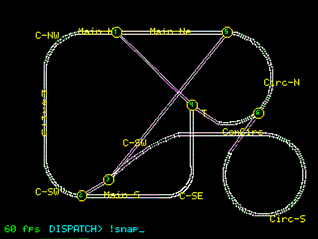

Posted: 01:13am 19 Mar 2026
Well, the bad with the good.
I wanted to add a new layout that I had found an image of:
I spent a little time with Gemini and a then little time with Chat trying to get them to produce the segments.csv file that I needed. They were terrible at it--I couldn't even get them to make sure that each segment was connected at both ends to another segment. (I did think that I might have been able to teach Chat to do it.)
So I produced the file by hand--not an easy task. An approximation--topologically ok.
I got it to where it would render, but trains would jump around crazily. So I realized that the original layouts (produced by Gemini through my describing them--much simpler than this one) all had their x1,y1 ends with lower x (or y if x1=x2) first. I had not done them this way by hand, and just randomly as was easiest. Each segment has a Next1 and a Next2 (and switches a Next3) indicating the segments the current one is attached to. So I went through and swapped Next1 and Next2 until they aligned with x1,y1 and x2,y2. The trains all ran fine.
Then I tried the A command (for assemble--build a connected train). And here's where the bad part began. It assumed that the segments were always drawn from the left to the right (or from upper to lower for vertical segments).
I went through several attempts yesterday to get Gemini to get it right. Today, it was a miserable 6 hours and still no success. This is the first time when I really could have done it faster myself--if I had written all the code and understood it.
I don't know where the problem lies. My feeling is that less compute is going into the answers than was the case 4-8 weeks ago. gadgetjack has speculated that AI coding is not good if you're not paying for it. My guess, and it's only a guess, is that you're not going to do as well as I had come to expect if you don't own the compute yourself--either because you're paying more than the $20 subscription, or because you have what it takes to run Claude Code locally.
I have my machine set up, but haven't started to use it. I was hoping to get this step working before making a big change to teach it what it needed to know (and to begin to teach myself what I will need to know).
So I still see the potential as huge. It just may not be as available as it first appeared to be. With so much effort going into building the models, and such explosive growth among users, I suspect that users are going to be shortchanged for some years until the availability of compute and memory increase significantly.
Posted: 03:38pm 28 Mar 2026
Layout 4 Youtube video: PicoRR Layout 4
1.25 or 1.5 speed is probably good.
The length of time since the last post--10 days--is indicative of struggles. Gemini basically quit working, with long stretches of unavailability. I got Claude Code API set up to run off of my MinisForum UM870 mini-PC, Ubuntu 24.04.4 LTS, 32GB DDR5 (it still goes to Anthropic for its AI). That did an extremely competent job of tracking down bugs in PicoDB and PicoRR (and adding enhancements).
Edited 2026-03-29 02:01 by lizby

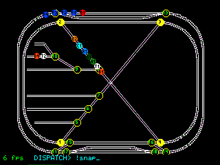

Posted: 10:59pm 31 Mar 2026
Layout 5 Youtube video: PicoRR Layout 5
Almost a lazy 8, but with a twist.
