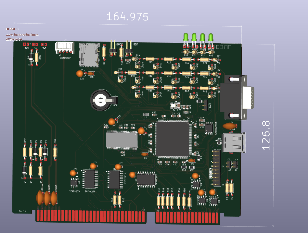

Just sharing some progress on my spare time project.
Decided to go with 16 bit VGA graphics and leave the hard stuff for a separate graphics card TBD.  Still need to add some basic sound on the MCU card but real sound capability will be on the audio card TBD.
USB Keyboard, VGA graphics, serial console and serial DFU.
SPI, I2C SAI and dual CAN on the backplane.
32MB SDRAM, 16MB QSPI Flash, 4bit MicroSD.
Older enthusiasts will recognise the slot.
Taking a road less traveled with the design language.
