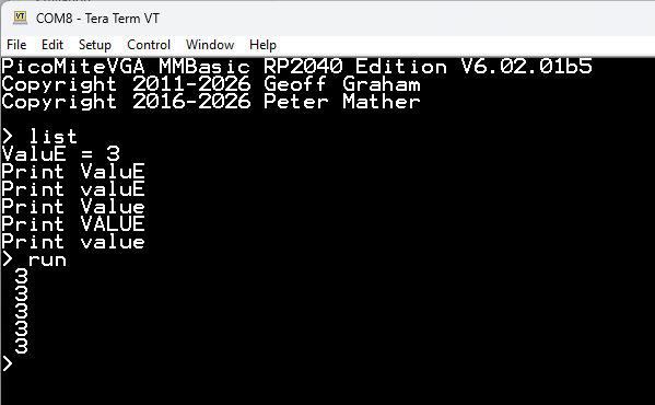

I am using MM Basic  user manual version Ver 5.07.04 which states that the interpreter is not CASE sensitive but I found otherwise recently.  I usually use capitals for all program names subroutines values etc and lower case for the rest. I downloaded a set of routines lately that had a mixture of cases that refused to run. I found after battling the error messages that a variable must be identical letter for letter to the definition.
For example if your variable  name is ValuE then none of the following are recognised as equal to ValuE. e.g valuE, Value, VALUE or value.
Has this always been the CaSe?

The only thing that is case sensitive is filenames on the A: drive which is a function of the LittleFS file system

Posted: 11:30am 23 Feb 2026
Just tried mmb4l and it behaves as expected (case insensitive variables).

Posted: 01:37pm 23 Feb 2026
Thanks for the reply matherp and JohnS. That is exactly what I expected to happen. I was battling with this all yesterday when it refused accept anything but the defined variable spelling. I tried your example and it worked then I thought perhaps the  OPTION SPECIFIC at the head  of my program made it case sensitive. I disabled that and  it worked so I replaced OPTION SPECIFIC and it continued to work!!! I give up as long as it works.
