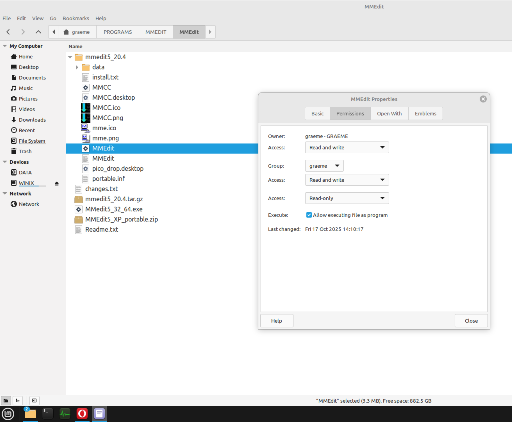

Open the folder where you extracted MMEDIT to from the downloaded ZIP file.
Right-click on the MMEDIT file(no extension)
Check that there is a tick in the "Execute" option - where it says to allow executing the file as a program.  If there is a tick in that box already, that's good.  If there is not a tick in that box, left-click it to put a tick in that box, then click the CLOSE button.
Double-click the MMEDIT file, and it should open.
If it does not, as per the readme.txt file, you may need to install a couple of extra packages.  Copy and paste the following, into the terminal(open the terminal first!)

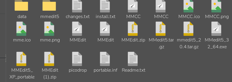

Jim , rpi 400 installed mmedit download.
made mmedit folder in home  and cut/pasted mmedi.zip to it then extracted here then extracted mmedit5.tar.gz and mmedt5 folder. This has mmcc icon and mmedit icon and set-rpi.sh and rpi folder with mmcc and mmedit.
I clicked set-rpi.sh and asked y? I thought the icons to click were in the rpi folder but are they the ones in the mmedit5 folder?
neither work on rpi. what am I doing wrong?

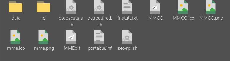

The mmedit I downloaded and extracted.

When you ran set-rpi.sh,
It should have copied the 2 files from the rpi folder to the main folder, replacing the ones that were there. I can't tell if that worked with the file manager in icon view. If the file sizes are not the same in the twp locations after running the set-rpi.sh script, it didn't work. In that case, use the file manager to copy the 2 files from the rpi folder into the main program folder, overwriting the ones that are there.
I would have thought you would run the dtopscuts.sh to get desktop shortcuts for mmedit but that is up to you.
If you prefer to run the programs from the file manager, it is the MMEdit and MMCC executable files in the main program folder you need to run.
If that doesn't work, I can't offer any further suggestions.

Jim, thanks for replying. I stsrted again from mmedit.zip, new download and did the install again. I checked the mmedit and mmcc in main folde size and in rpi folder befoe amd after running set-rpi.sh. They are now the same size.
double click mmcc or mmedit and window opens with execute, execute in terminal, open, cancel. clicking execute and nothing happens.
