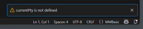

I get a message when I try to send the program (CTRL+Alt+U)
What could be the problem...
Yes, I am a beginner at VSCODE
/Peter63

A small update from me. Sending programs to PicoMite now works from VSCODE (I had to activate Terminal first...)
Using: mmbasic-support-0.0.7.zip  (VSIX-file)
/Peter63
