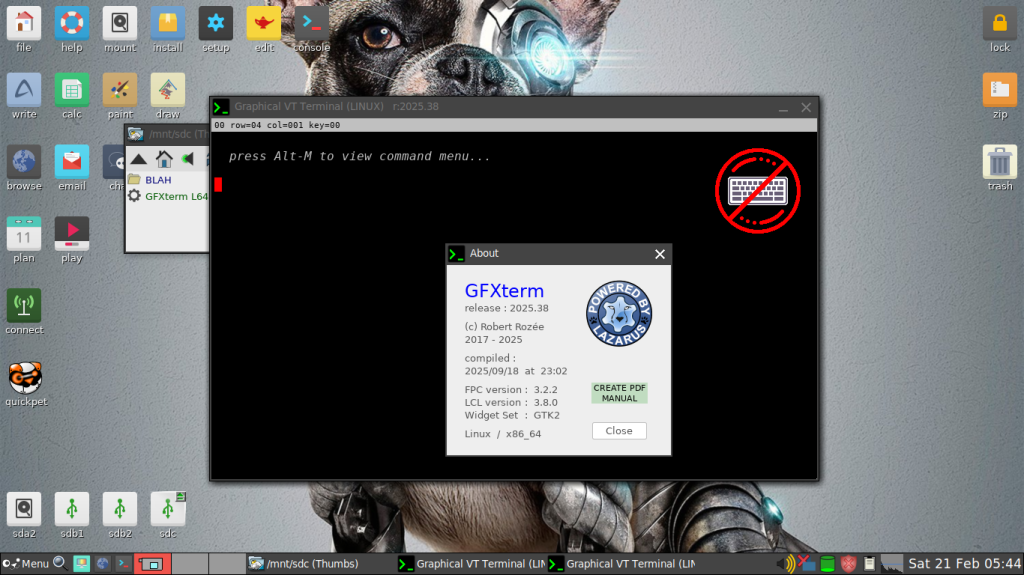

It worked the very first time I tried to run the GFXterm file in Puppy.
No error messages, no need to run in the terminal, it just popped up as expected.
I'm using an old-ish Bionic64(v8.0) Puppy image using Linux Kernel 4.19 circa February 2019.
This is a small-ish ~300MB ISO, which is plenty small enough for my simple serial terminal and logging purposes.

Posts: 10104
Posted: 06:57am 21 Feb 2026
Also works fine ScPup64(Slackware Current), which has a default Windoze XP-ish GUI.  This uses Linux Kernel 5.4.6(December 2019), so a little more up to date kernel-wise.
