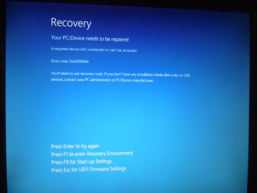

When trying to boot from usb bootable using power tapping F2 or F12 get this each time.
life's too short. pc duff. only £70 dell inspirion small desktop pc.

So are you getting into the BIOS? That screen isn't it.
Tapping F2 or F12 while booting should do that. You can also try Fn+F2 and Fn+F12. It's almost always just F2 for Dell.
Once in the BIOS you can start to make the changes that you need to prevent Windows from taking over during boot.

ville56
Joined: 08/06/2022
Location: Austria
Posts: 665
Posted: 07:30pm 18 Feb 2026
my guess would be press ESC as the UEFI firmware should be what we used to call BIOS

Posts: 9328
Posted: 07:48pm 18 Feb 2026
That's likely. It's certainly worth trying.
An error like that makes me think that the HDD might be disconnected or even missing! It's what you get when Windows is corrupted and can't start.
Edited 2026-02-19 05:50 by Mixtel90
Posted: 09:07pm 18 Feb 2026
F1 is probably a DOS/PowerShell, I'd avoid it except I might use
powercfg /h off
if it'll let you.
F8 might be useful
Esc looks most useful, I'd try that and then try to set your USB to boot first so you can boot Linux from a USB stick.
And turn off fastboot if it has it.
stanleyella
Joined: 25/06/2022
Posts: 2807
Posted: 09:11pm 18 Feb 2026
I got it to load. The idea was make the usb bootable with etcher or rufus then press F12 on boot and should boot from usb not internal C: ssd.
F12 worked eventually with boot from usb option.
