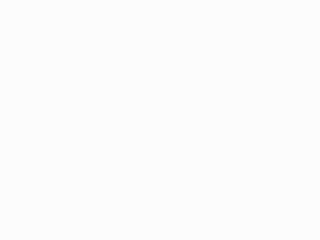

This has worked for me with the RP2040 before, but this is with an RP2350.
SAVE IMAGE "RR-1.bmp" produces this image when sent with XMODEM S "RR-1.BMP"

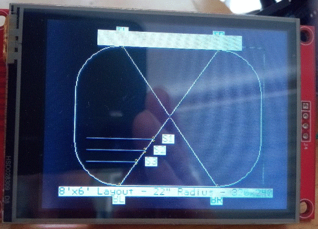

Photo is:
(Or I'm doing something wrong.)

What do you get if you try:-
CLS : LOAD IMAGE "RR-1.bmp"
That will show whether the problem is with Xmodem or Save Image.
If it is not saving the image the usual problem is between LCD_DO and MISO.
If the screen is a ILI9488 you need the diode/resistor fix. IN4004 anode to LCD_DO, K to MISO. 1.8kΩ from MISO to LCD_CS.
For other screens test continuity from the top of the LCD_DO pin to the top of the MISO pin.
If the touch T_DO pin is connected to MISO you must either enable OPTION TOUCH or add a 10K pullup resistor to T_CS. Otherwise T_DO can go low and block all other input to MISO.

  phil99 said  If it is not saving the image the usual problem is between LCD_DO and MISO.
Bingo! I was wiring it with Dupont cables, and when I got it to display, I quit, leaving DO/MISO unconnected.
Thank you.
