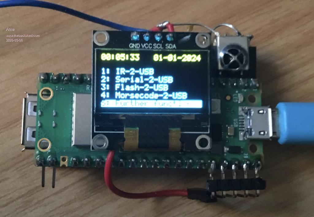

Hello,
I am actually working on (I call it) „USB - injector“.
It consists of 2 picos. On one pico MMBasic is installed which controls the second pico with HID-remapper.
On a Picomite USB it will be detected as a keyboard and you can inject HID commands and characters.
On a PC/Mac etc. in addition mouse and gamepad functions are available.
Here a foto of my prototype
The display is operated with an IR-Remote.
With the actual version I can transfer ASCII-text and some control characters.
Arne

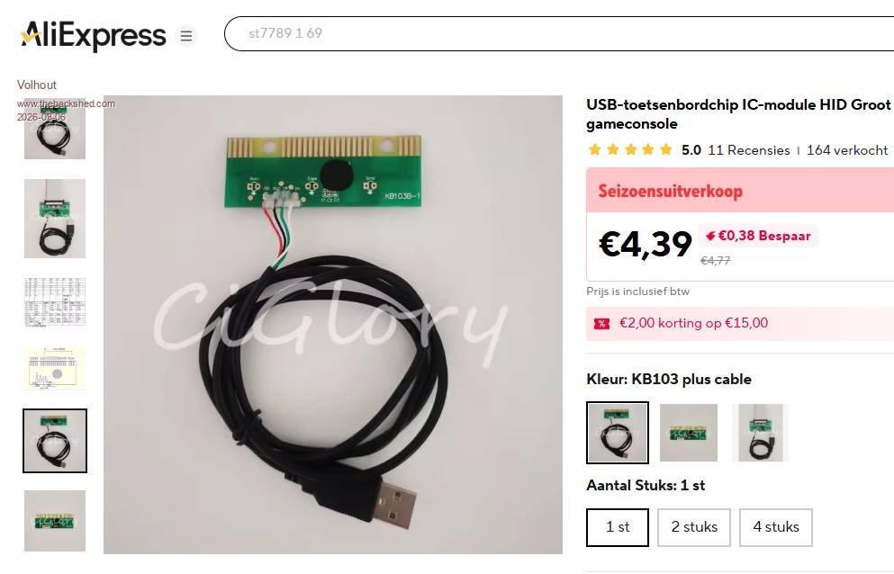

Posts: 3429
Posted: 09:26pm 05 Mar 2026
  Mozzie said  After trying several keyboard emulators with CircuitPython for the disabled / elderly, I believe MMbasic / PicoMite would be a far better platform.
The idea of a 7" touchscreen keyboard that can be customised endlessly also springs to mind.
Do you have to emulate a USB keyboard?
Perhaps emulating a PS/2 one would achieve the same result.
Peter posted a program using the new 2 pin Bitstream command in this thread.
https://www.thebackshed.com/forum/ViewTopic.php?FID=16&TID=18567#249548
It emulates a PS/2 keyboard.
At the end of the thread is a slightly edited version that uses a couple of more efficient MMBasic commands that Claude missed.
Edited 2026-03-06 07:32 by phil99

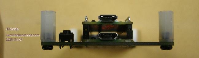

Due to the addition of the USB-CDC to the latest PicoMite firmware this project is possibly redundant, however if keyboard emulation is required this is still relevant.
Many thanks to Arne for pointing out HID Remapper and Jacek Fedorynski for his awesome project.

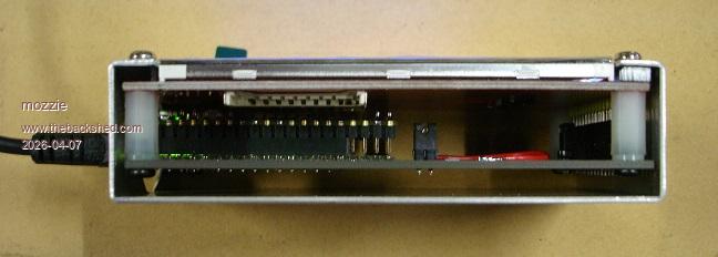

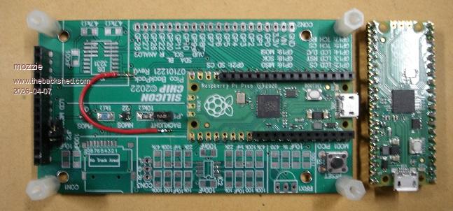

The HID Remapper firmware allows a Pico to emulate a keyboard, mouse or gamepad and can be configured via software to allow remapping existing USB keyboards etc or GPIO to keystrokes and macros, this allows up to 24 GPIO to be used, 2 are reserved for USB. The analog inputs can be used for joystick functions as well or can optionaly control mouse movements.

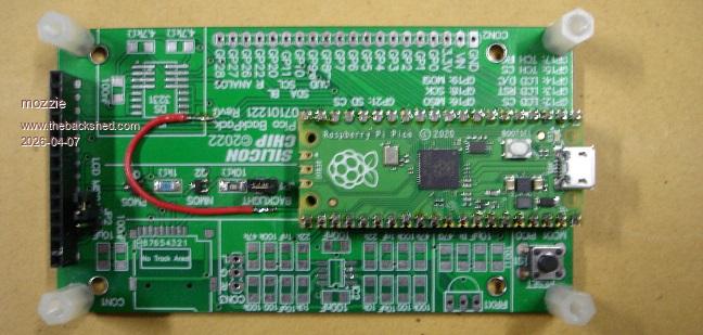

The PicoMite backpack PCB has an RP2040 and ILI9488 with touch. The red wire link moves the LCD CS to GPIO21 and this means we have GP0-GP12 and GP22-GP28 connected from the PicoMite to the HID Remapper.
The HID Remapper allows 4 layers of keys to be set for different applications. This means with 17 GPIO at our disposal we have either:
17 keys - layer 0 only
32 keys - 16 keys x 2 layers (1 wire select)
45 keys - 15 keys x 3 layers (2 wire select *)
56 keys - 14 keys x 4 layers (3 wire select *)
* it appears binary selection of layers is not possible.
The above provide direct control of layer selection, however a little fiddling has shown that the layers can be selected with a single GPIO in rotation so if speed is not so important we get:
64 keys - 16 keys x 4 layers (1 wire pulse select)

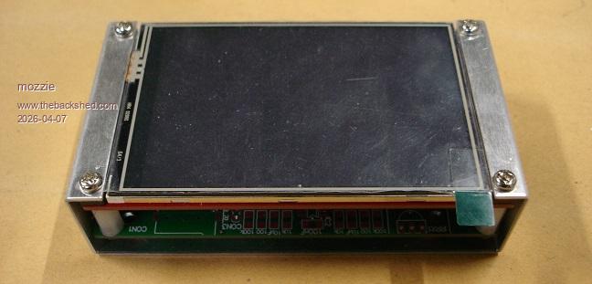

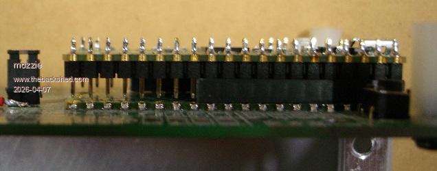

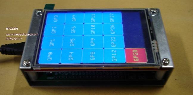

For most of the uses I can think of this should be more than enough. The 2 Pico's are simply mounted piggyback style using short headers and just miss the SD card socket on the rear of the LCD. The test software pulses the GPIO pin shown on the button for 5ms and the GP28 button controls the current layer.
Finally got the folder moved to a more usable position so made a simple case as well.
This also works as an input device for the PicoMite USB firmware so may be useful to someone.
