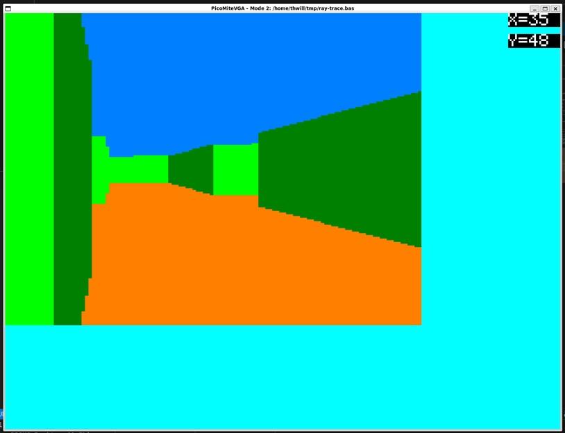

A screenshot for those who are interested, but not enough to crank up the 'Mite:
Generated by MMB4L running under WSL2 on Windows whilst simulating a PicoMite .
Edited 2026-02-09 20:49 by thwill

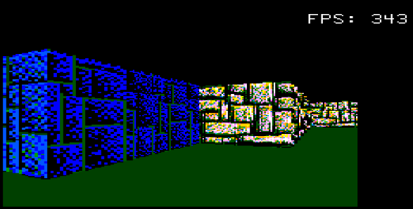

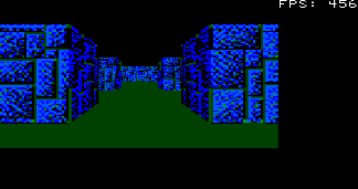

How about this ? - -worth including in the RP2350 firmware?
Manual:
Raycaster_User_Manual.pdf
Example code:
