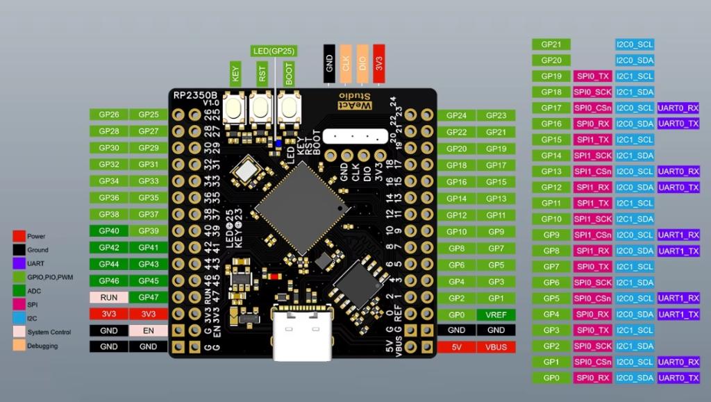

Posted: 01:49am 05 Feb 2026
This looks like a good base for projects which don't try to replicate Peter's excellent 64-pin DIL PCB.
With the USB connector down, the right 2 rows of pins effectively replicate the Pico 1 pins, with their respective functions.

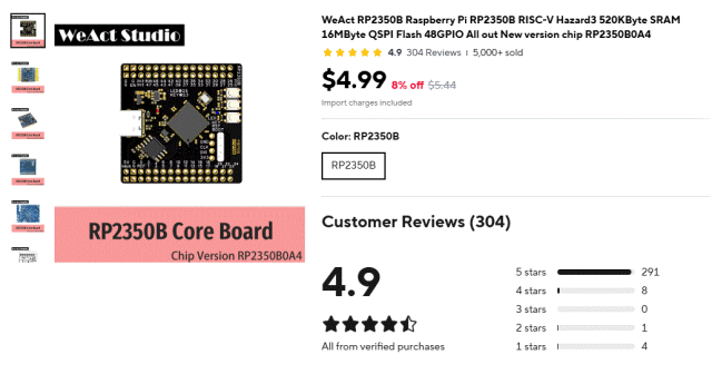

$4.99USD if 3 purchased from Aliexpress:

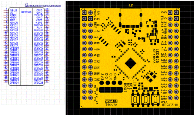

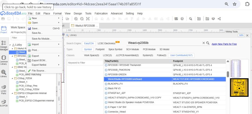

The EasyCad footprint is available in the Standard (not Pro) version under "User Contributed" as WeActStudio.RP2350BCoreBoard (I couldn't find it under Pro):
In EasyCAD:

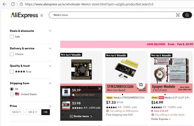

Posted: 04:16pm 05 Feb 2026
  Mixtel90 said  I'm getting a "Love Delivers" page, not a WeAct page. It lists several WeAct items but they are all STM32, CANFD, Mini Debugger and ESP32. Not much WeAct and no WeAct RP stuff at all.
Yes, the page I get is "Love Delivers", but the RP2350 is the upper leftmost item:
If I click on that, I get the "Dollar Express" page which also has the module (among others), and if I click on that, I can order it.

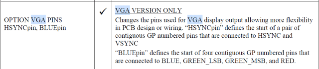

Per the Picomite manual for setting alternate VGA pins:
Would this apply to the upper pins of this module, e.g., GP27, 28, 29, 30 for blue, green1, green2, and red?
Edited 2026-02-08 04:41 by lizby
Posts: 9328
Posted: 06:50pm 07 Feb 2026
I think I might have tried it at some point. It will probably work. AFAIK there's nothing special about the VGA pins apart from the fact that they have to be consecutive. There's no special internal hardware like there is for DVI/HDMI.
