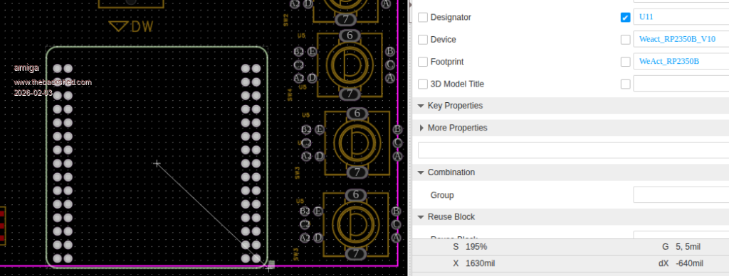

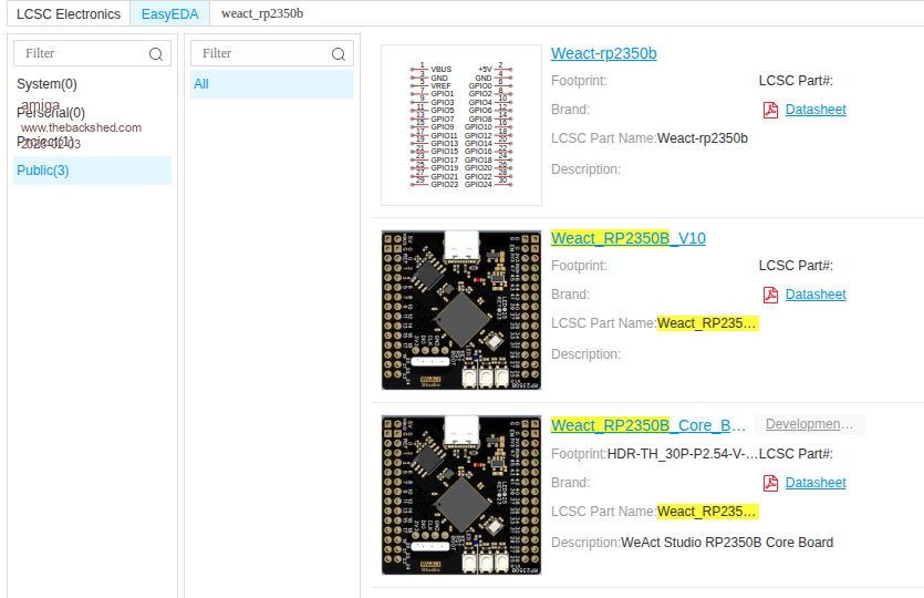

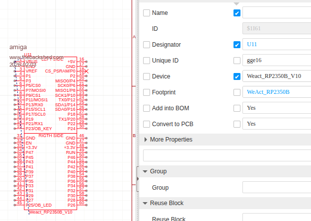

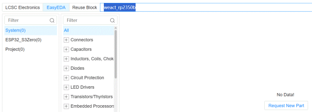

hi ,
i use easycad pro , in schematic the layout is ::

  amiga said  i use easycad pro , in schematic the [WeAct] layout is ...
Thank you. Super. That's only the outer pins, though, isn't it? Or is the V10 device the one to use for all pins?
A question for Peter (or anyone): what does 16MB PSRam do for us on this WeAct module?
[In EasyEDA Pro, I'm not finding the part. Any clues on how to look?

  ville56 said  FYI, I possess two of these WeAct modules. Mine have a CPU stepping A4 and 8Mb PSRAM. The PSRAM was retrofitted by me as well as the missing pullup for the CS signal. The problem I have with this modules is, that none of the usual "nuke" programs seems to work on them. So if you set the options to something you cannot recover from without nukeing the flash it is a bit cumbersome. I usually flash some other, much older version of MMBasic over the failing one. That did work so far as it seems to change the options store to something that allows to reflash and go ahead. The behavior is independent of the PSRAM. The new, untouched modules behaved the same.
oups .. thanks for the info .
i ordered 1 module for testing , if not work , take the highway to my museum  .
it's the version of the pico 2 (chip RP2350B0A4) not compatible picomite or buggy silicon?
after some optimisation due to the form factor (100mm*100mm) for jclpcb i shrinked my new version to 28 gpio .. in this case i have more choice for the pico 2 boards, but wich chip version with less buggy?
