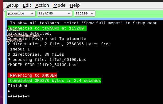

Posted: 06:59am 27 Jan 2026
@Jim,
The new MMCC works. It tries Y-modem first I guess. Not sure what the non-ASCII characters are at the end (before the prompt).

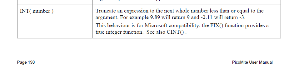

I just noticed that "int" is coloured blue as if it is a keyword. I couldn't find it in any manual but it happens in all versions of the syntax I tried. I can't find it in any manual. Is it correct? The program runs without error.
offset = INT(visibleCount / 2)
Posted: 06:15am 20 Feb 2026
INT has been there since the dawn of time, or at least the birth of MMBasic
Turbo46
Joined: 24/12/2017
Posts: 1694
Posted: 06:27am 20 Feb 2026
Thanks Jim, Now I can find it everywhere and that's what it's used for in the program. Sorry to waste your time. DOH!

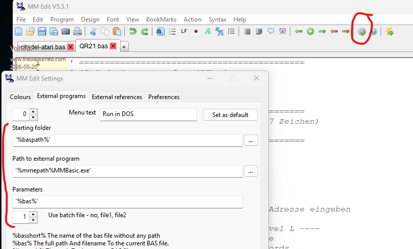

I use MMBasic for DOS and MMB4W in conjunction with MMedit often to develop programs because the write code and test turnaround is so quick. Because the 'Run in DOS' button is so convenient, I was wondering if we could have one for MMB4W? Failing that, would it be possible to have the DOS button's function governed by the syntax selection?

  Quote   Because the 'Run in DOS' button is so convenient, I was wondering if we could have one for MMB4W?
Not easy and I am trying to limit the number of buttons. There are too many. I will think about it.

Holding <ctrl> while clicking the "action" button (3rd from right) will run option "0". (Run in DOS by default)
