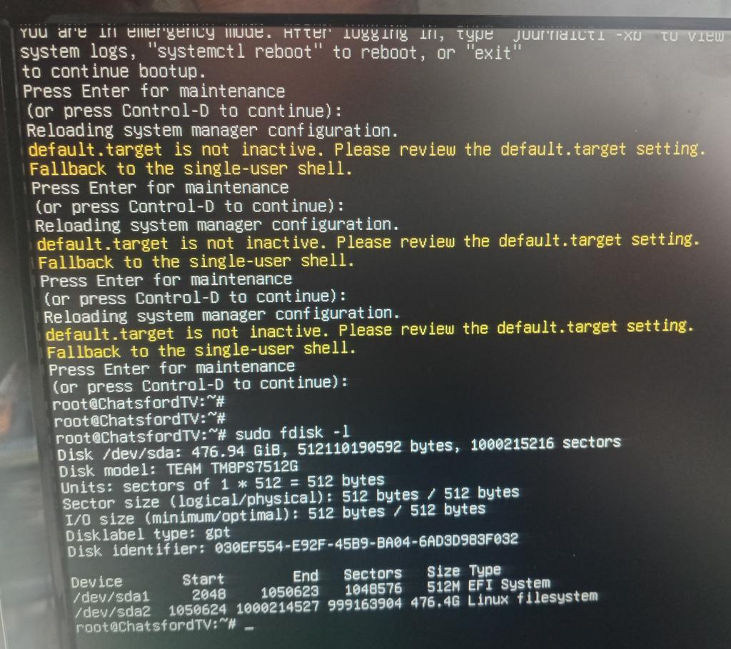

THIS process worked MUCH better, but still fails to "Proceed" into the system.
IT DOES BOOT after the restore, but refused to load the desktop GUI.
I get the standard "LM" boot-up logo/image, but the system then falls over to text-only terminal mode.
This takes about two minutes of "Logo show", before all I get is text-mode terminal.
Basically, this is a CRASH at this point.
Asks for my username and PW to continue(at terminal mode), and I supply that, and THAT IS ACCEPTED, then the system never recovers to the GUI.

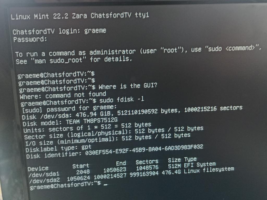

Posts: 10104
Posted: 11:01pm 17 Jan 2026
  Mixtel90 said  "Fascinating" or downright infuriating - like me trying to learn how to fly a drone in acro mode?  :(
Both.
Infuriating to some extent, yes, but not in a HUGE way, as I expected there to be hiccups, and as this is my test machine, it does not affect my main machine, so if I get stuck, I just turn the monitor off on the test machine and go back to this one till I can find something else to try later - saves stress!
This is what I am seeing when I boot up:
It's upset, cos it says it is in "Emergency mode"
I type "login", and log into the account I created for this machine.
At that point, I am stuck.
Anyone got any pointers as to perhaps a command I need to type or a config file I need to edit to get things booting again?
dddns
Joined: 20/09/2024
Posts: 925
Posted: 11:30pm 17 Jan 2026
Your root partition could not be mounted. Boot with a live stick and this will show you all UUID's:
blkid
Then click on /dev/sda2/ with the filemanager and navigate to /etc. Open it as administrator and edit /etc/fstab
Look in the first line with "/" and enter the UUDI you saw with blkid above for /dev/sda2
save it and reboot
Hope that helps :)

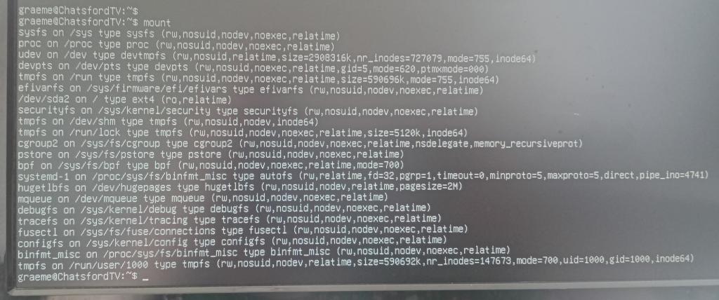

dddns
Joined: 20/09/2024
Posts: 925
Posted: 11:53pm 17 Jan 2026
The second pic is confusing, what is the output of
mount
Posts: 10104
Posted: 03:26am 18 Jan 2026
Thanks, I will try the UUID thing now.
Results of 'mount':
