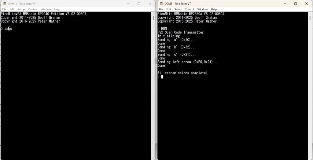

Posted: 12:18pm 16 Jan 2026
Posts: 11519
Posted: 12:21pm 16 Jan 2026
Typo on the picure. Should say 0xE0,0x6B for left arrow.
Here is the code. Needs RC7 to run. I'll post this later today
' PS2 Keyboard Scan Code Transmitter
' Uses dual bitstream with two pins in open-collector mode
' Simulates PS2 device-to-host transmission
' PS2 Protocol (device to host):
' - Clock: 10-16kHz, open-collector
' - Data: open-collector, changes when clock is HIGH
' - Data sampled on falling edge of clock
' Frame format (11 bits):
' 1. Start bit: DATA = 0
' 2. Data bits 0-7: LSB first
' 3. Parity bit: Odd parity
' 4. Stop bit: DATA = 1
Const CLK_PIN = 19    ' PS2 Clock pin
Const DAT_PIN = 20    ' PS2 Data pin
' PS2 timing (microseconds)
Const CLK_LOW = 40    ' Clock low time
Const CLK_HIGH = 40   ' Clock high time
Const INIT_DELAY = 50 ' Initial delay before first clock
' Initialize pins (call once at startup)
Sub PS2_Init
 SetPin CLK_PIN, DOUT
 SetPin DAT_PIN, DOUT
End Sub
' Transmit a PS2 scan code
' scanCode: 8-bit scan code to send
Sub PS2_Send(scanCode As Integer)
 Local bits(10) As Integer
 Local clkTiming(30) As Integer
 Local datTiming(30) As Integer
 Local clkIdx As Integer = 0
 Local datIdx As Integer = 0
 Local currentData As Integer = 1
 Local dataTime As Integer = 0
 Local bitVal As Integer
 Local i As Integer
 Local parity As Integer
 Local count As Integer = 0
 ' Calculate parity (odd parity)
 For i = 0 To 7
   If (scanCode >> i) And 1 Then count = count + 1
 Next i
 parity = (count + 1) And 1
 ' Build the 11-bit frame
 bits(0) = 0  ' Start bit
 For i = 0 To 7
   bits(i + 1) = (scanCode >> i) And 1
 Next i
 bits(9) = parity
 bits(10) = 1  ' Stop bit
 ' First bit - data changes before first clock falling edge
 bitVal = bits(0)
 If bitVal <> currentData Then
   datTiming(datIdx) = INIT_DELAY - 5 : datIdx = datIdx + 1
   currentData = bitVal
   dataTime = 5
 Else
   dataTime = INIT_DELAY
 EndIf
 ' First clock transitions
 clkTiming(clkIdx) = INIT_DELAY : clkIdx = clkIdx + 1
 clkTiming(clkIdx) = CLK_LOW : clkIdx = clkIdx + 1
 ' Process remaining bits (1-10)
 For i = 1 To 10
   bitVal = bits(i)
     datTiming(datIdx) = dataTime + CLK_LOW + 5 : datIdx = datIdx + 1
     dataTime = CLK_HIGH - 5
   Else
     dataTime = dataTime + CLK_LOW + CLK_HIGH
   EndIf
   clkTiming(clkIdx) = CLK_HIGH : clkIdx = clkIdx + 1
 Next i
 ' Return data to HIGH if needed
 If currentData = 0 Then
   datTiming(datIdx) = dataTime + CLK_LOW + CLK_HIGH : datIdx = datIdx + 1
 EndIf
 ' Ensure even number of data transitions
 If (datIdx And 1) = 1 Then
   datTiming(datIdx) = 50 : datIdx = datIdx + 1
 EndIf
 ' Transmit
 Device BITSTREAM CLK_PIN, clkIdx, clkTiming(), 1, DAT_PIN, datIdx, datTiming(), 1
End Sub
' ============ Test Program ============
Print "PS2 Scan Code Transmitter"
Print "Initializing..."
PS2_Init
Pause 1000
Print "Sending 'a' (0x1C)..."
PS2_Send(&H1C)
PS2_Send(&HF0):PS2_Send(&H1C) 'send the key up
Print "Done!"
Pause 500
Print "Sending 'b' (0x32)..."
PS2_Send(&H32)
Print "Done!"
Pause 500
Print "Sending 'c' (0x21)..."
PS2_Send(&H21)
Print "Done!"
Print "Sending left arrow (0xE0,0x21)..."
PS2_Send(&HE0):PS2_Send(&H6B)
PS2_Send(&HE0):PS2_Send(&H6B):PS2_Send(&H1C) 'send the key up
Print "Done!"
Print
Print "All transmissions complete!"
End
Pause 100
'Dim integer txt(33)=(18,77,240,18,45,67,49,44,41,18,82,27,240,18,33,28,49,41,33,68,35,36,41,44,36,27,44,18,82,240,18,90,240,90)
Print "Sending SCAN CODE TEST"
Math v_print txt()
For n=0 To 33
  PS2_Send txt(n) 'Works Ok to another Pico PS/2 console input, with or without pullups.
  Pause 50
Next
Print
Print "Sent"
