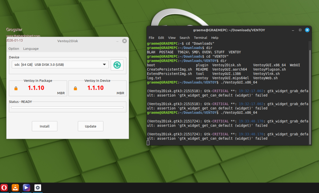

Setting up Ventoy tonight, I ran into some problems.
The application(once unzipped), would simply not run.
Borrowing from recent knowledge of the power of the Linux terminal, I opened the terminal, and navigated to the download folder, and used my new Linux-Love: "./"
THIS WORKED, and the GUI then popped up, but the terminal was reporting some "CRITICAL" errors, but despite reading the messages several times, I am still lost as to what Linux is trying to tell me.
Can someone look at this screenshot, and tell me what Linux is upset about?
Despite Linux moaning about this, the application ran and completed fine, and I will now have a bit of a tinker about with it.

I web searched for
gtk_widget_grab_default gtk_widget_get_can_default failed
and it looks probably harmless plus may be due to running from the terminal.
You could set up a desktop item so it runs with a click or two.
Be careful of typing wildcards (the * character) with rm!!  Unless you have rm -i it's risky if you're also a bit hamfisted with the space bar.
E.g. rm test.* or rm *.old are fine but a stray space would be a disaster.

Pretty standard terminal error/info output when run from terminal, some are permission errors or missing info depending on the Linux system.
