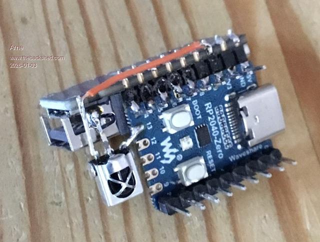

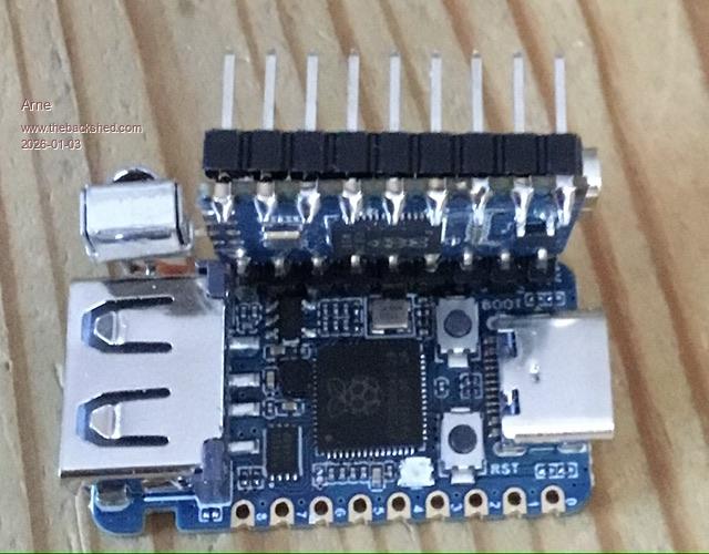

Hello  Bill,
You can use HID-Remapper on a second pico. It could be adapted/configured to your needs via browser and controlled by MMBasic thru the GPIOs. Here fotos of my actual prototype as IR-Controller.
I actual made some tests to use it as a multi remote control.
Without the second pico you can control the MMBasic editor e.g. with mouse or joystick etc.
See also my post „Picomite & HID-Remapper“.
Arne

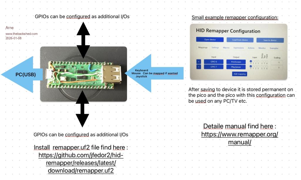

Hello Bill,
To do the things you wanted MMBasic is not needed.
Do it directly with HID-remapper:
- solder 4 lines to the pico (see also manual/picture)
- install remapper.uf2 on the pico (e.g.  rp2040 version)
- connect switches/LEDs etc. to the relevant GPIOs (e.g. to make your own controller)
- configure via browser
- save configuration permanent to pico
Thats it. The hardware can be used on PC/ Mac/Picomite etc.
Here a short overview to have an idea:
Have fun
Arne

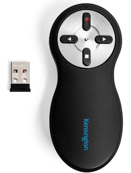

I have a edge case use, which is that I wanted to swap the "blank presentation" button from sending "B" to "W" as I want a white screen not black.  So began my odyssey into all things Bluetooth, HID etc.
Customizable clickers are available which use a little app to customize the buttons - but this needs to run on the host pc, which the "IT GODS" in work wont let me install.  So you need to customize the clicker itself.  None like this were available for less that £60-£70 so I thought I'd have a bash at making one.
How hard could it be?  Microcontroller, BLE stack and a few buttons / charging circuit etc.  So it began.
