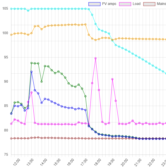

Posted: 01:27am 03 Jan 2026
  Quote  This project is for one of our repeater sites
Chart from VK7RTV for yesterday.(Using the INA3221)
Green is peak solar output, blue is average solar.
I also monitor the radio usage with a webmite. It is at least 18 months since I touched the webmite. Provided you don't push the speed too high, they are very reliable.
