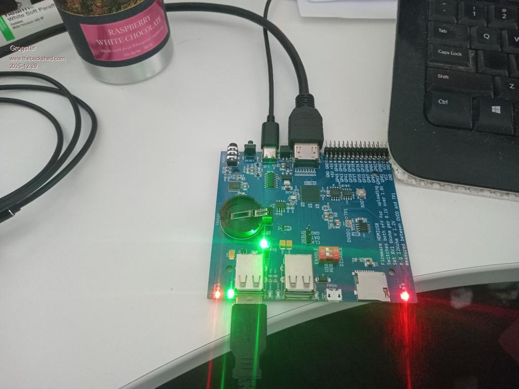

Very sexy!
Easy to setup, cheaper to produce then the CMM2G2v2(with no disrespect), and lovely feature-set.
I've only now had a chance to play with these, as up until now, I have been busy with work.
But now I am on my Christmas holiday, I can spend a bit of time, tinkering with things like this.
I have not yet tried out everything, but I must spew forth, my absoulute LOVE of the included audio DAC chip.  This is BRILLIANT, when hooked up to a good amplifier.
Again, no disrespect to the wonderful LPF on the CMM2 etc - Volhort did brilliant work there, but the fact is, that a dedicated DAC will always be better then PWM + LPF.
Four-port USB hub is an excellent idea, and with the HDMI video, this thing is just about perfect.  The only complaints you will get now, are those moaning that the audio is not on the HDMI port.....because people are never happy.

Posts: 10104
Posted: 05:16am 30 Dec 2025
MP3 playback is SLOW, and interrupted with pops and clicks.
WAV is fine.
WHAT MP3 FILE COMPRESSION PROTOCOLS(bitrates etc) ARE SUPPORTED BY THE DAC/MMBASIC on the 2350B CHIP?
I am working on making a sample video so I can post it here.
Perhaps some bitrates are NOT supported?
Posts: 10104
Posted: 05:25am 30 Dec 2025
It seems.........
Posts: 10104
Posted: 05:30am 30 Dec 2025
......not all SD cards are equal.
Copied the MP3 files to another SD card, and they are ALMOST perfect.
First card was a 128MB(yes, MB) uSD card for experimentation, formatted as FAT32.
Copy rate was about 2.6MB per second, so I thought it would have no trouble reading MP3 data.  Seems not.
Next test was 8GB ADATA, also formatted as FAT32.
No pops or clicks on playback with this one, but still the OCCASIONAL skip, in the order of about 200ms or so of skipped audio output.
IS THERE A RECCOMENDED MINIMUM SD CARD SIZE AND SPEED for use with this unit?
As I say, WAV playback is FLAWLESS(even from these same cards), but mp3 is a bit "Jittery" at times.
With the size of SD cards these days, there is no reason to NOT use full uncompressed WAV files, I guess!
