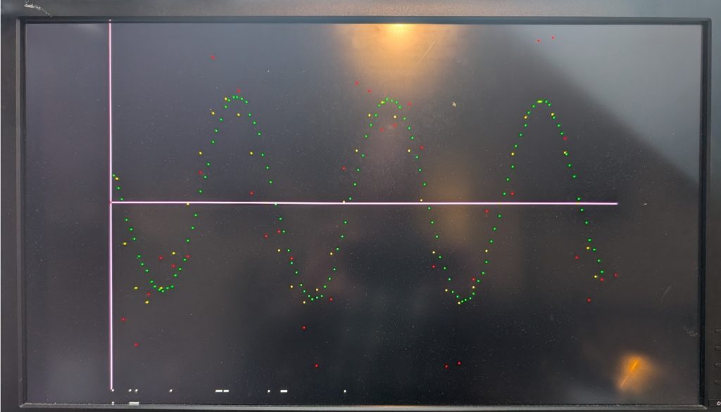

You should have said you wanted some curve fitting before I finished the release. I've just implemented a sin(x)/x (sinc function) including sinc interpolation
red = original points
yellow = 1:1 smoothing
green = interpolated output
' Demo: unified SINC smoothing vs interpolation
OPTION EXPLICIT
mode 2
CLS
CONST N = 40          ' input points
CONST M = 120         ' resampled output points (m != n triggers interpolation)
CONST WIN = 17        ' window size (odd)
CONST FREQ = 0.12     ' normalized cutoff (0<freq<=0.5)
DIM x_in(N), y_in(N)
DIM x_s(N), y_s(N)       ' smoothed outputs (m omitted => smoothing)
DIM x_out(M), y_out(M)   ' resampled outputs (m provided => interpolation)
DIM i%, xi%, yi%
' Build a test waveform that fits the screen
FOR i% = 0 TO N - 1
 x_in(i%+1) = (MM.HRES - 1) * i% / (N - 1)
 y_in(i%+1) = (MM.VRES\2) + (MM.VRES\3) * SIN(2 * PI * i% / 12) + 0.15 * MM.VRES * SIN(2 * PI * i% / 5)
 IF y_in(i%+1) < 0 THEN y_in(i%+1) = 0
 IF y_in(i%+1) > MM.VRES - 1 THEN y_in(i%+1) = MM.VRES - 1
NEXT
' Smoothing (m omitted => m=n internally)
MATH SINC x_in(), y_in(), N, WIN, FREQ, x_s(), y_s()
' Interpolation/resampling (m provided)
MATH SINC x_in(), y_in(), N, M, WIN, FREQ, x_out(), y_out()
' Clear and draw axes
CLS
LINE 0, MM.VRES\2, MM.HRES-1, MM.VRES\2, 1, RGB(GREY)
LINE 0, 0, 0, MM.VRES-1, 1, RGB(GREY)
' Plot original points in red
FOR i% = 1 TO N
 xi% = INT(x_in(i%))
 yi% = INT(y_in(i%))
 IF xi% >= 0 AND xi% < MM.HRES AND yi% >= 0 AND yi% < MM.VRES THEN PIXEL xi%, yi%, RGB(RED)
NEXT
' Plot smoothed points in yellow
FOR i% = 1 TO N
 xi% = INT(x_s(i%))
 yi% = INT(y_s(i%))
 IF xi% >= 0 AND xi% < MM.HRES AND yi% >= 0 AND yi% < MM.VRES THEN PIXEL xi%, yi%, RGB(YELLOW)
NEXT
' Plot resampled points in green, slightly offset upward for visibility
FOR i% = 1 TO M
 xi% = INT(x_out(i%))
 yi% = INT(y_out(i%)) - 2  ' small offset for visibility
 IF yi% < 0 THEN yi% = 0
 IF yi% >= MM.VRES THEN yi% = MM.VRES - 1
 IF xi% >= 0 AND xi% < MM.HRES THEN PIXEL xi%, yi%, RGB(GREEN)
NEXT

Hi Peter,
Nice, but I am not working on such now, but it is always on the back of my mind.

Posted: 02:16pm 19 Dec 2025
I've asked Geoff to include this in the next update of the manual but in the meantime be aware there is a very nice new MATH sub command in 6.01.00. The sinc command implements the same sin(x)/x smoothing typically used by digital oscilloscopes. Example code is in my post just above. The result is pretty impressive IMHO.
 MATH SINC x_in(), y_in(), n , m, window, freq, x_out(), y_out()
 MATH SINC x_in(), y_in(), n, window, freq, x_out(), y_out()
 Apply a windowed sinc filter to smooth or interpolate coordinate data.
   A sinc filter is an ideal low-pass filter that removes high-frequency noise while preserving
   the signal shape. It is particularly good for resampling (interpolation).
   Parameters:
     x_in(), y_in() : Input coordinate arrays (float)
     n              : Number of input points
     m              : Number of output points (optional)
                      - If omitted or m=n: Smoothing mode (output size n)
                      - If m!=n: Interpolation/Resampling mode (output size m)
     window         : Filter kernel size (must be odd; even values are incremented).
                    Typical values: 15 to 101. Larger values give a sharper cutoff but are slower.
     freq           : Normalized cutoff frequency (0.0 < freq <= 0.5).
                      0.5 is the Nyquist frequency (no filtering).
                      Typical values: 0.1 (heavy smoothing) to 0.4 (light smoothing).
     x_out(), y_out(): Output coordinate arrays (must be large enough to hold output)
