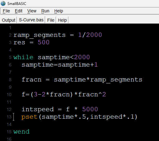

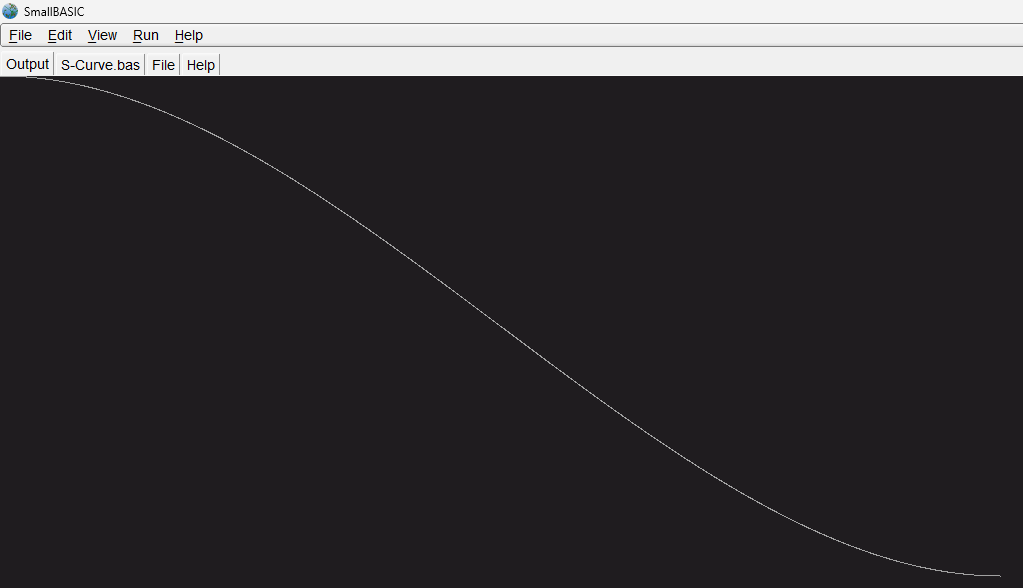

This is the most efficient s-curve that I have come across:
I have it in SmallBasic here:

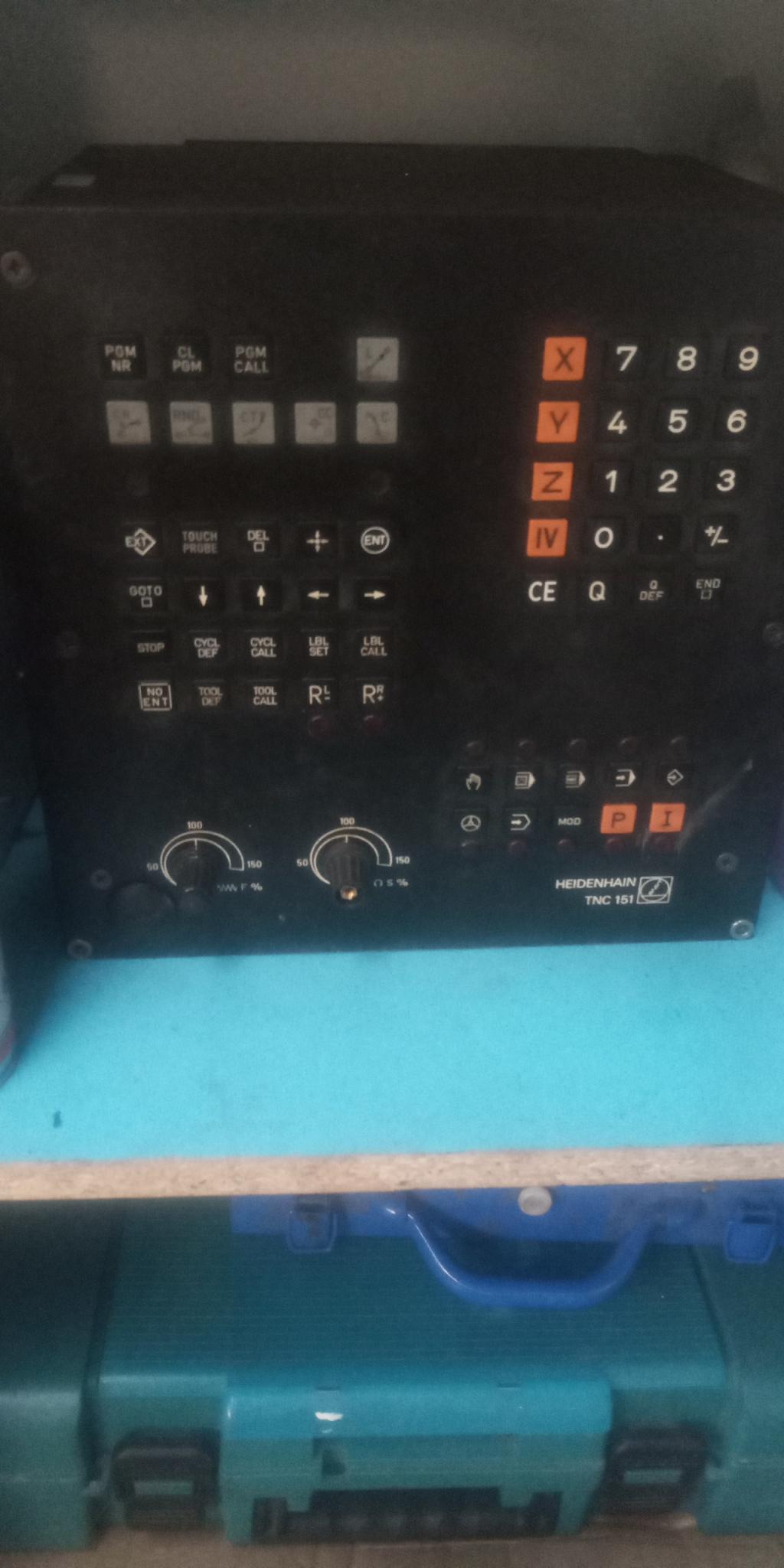

Two ideas: please take a look at the Heidenhain  dialect introduced with TNC151/155
And in any case, radius compensation is a very practical feature

  dddns said  Two ideas: please take a look at the Heidenhain  dialect introduced with TNC151/155
I have two dead TNC151s on Bridgeports and a third that is on borrowed time.
