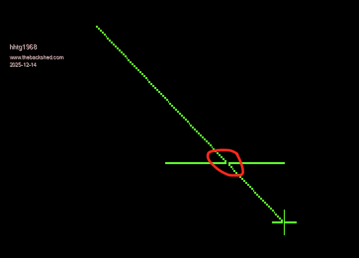

In a kind of paint programm i usually program that you can click the firstpoint of a line and then you can hold the button to go to the end point during the line is drawed continously. the backgroung should not be destroyed so i use xor to show the recent line and xor again to show the original backgroung (my english is not so good).
I want to draw a graphic line (or a box or a circle...) with live display, without permanently painting over or damaging the background.
otherwise i had to cache the background.
hhtg1968
Joined: 25/05/2023
Posts: 317
Posted: 03:23pm 13 Dec 2025
In the example image, I've circled it in red. The line with the cross isn't final yet. You can see the inversion at the intersection...
because of the inversion by XOR the background is not destroyey if i draw with XOR again...
this example is on my z80 computer.

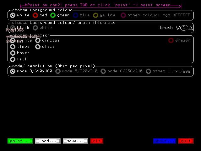

because of the help from vegipede I continued to code my simple painting program. there is no real sense because there are thousends of such programms for "normal" computers and you can transform pictures via sd card to the cmm2. but i wrote for every system a paint program for fun.
menu page (gui commands from geoffg):
paint page:
At the beginning i do not code with events for mouse etc. so the main loop runs fast and the commands
"gui cursor on" and "cursor off" was called very often. i have changed this and all is well.

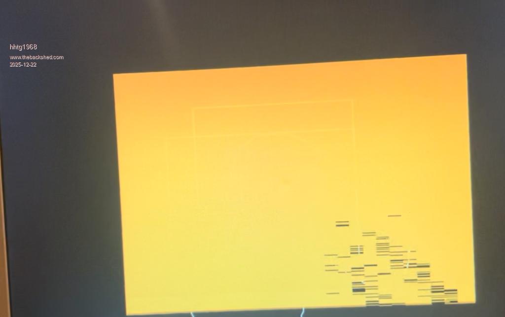

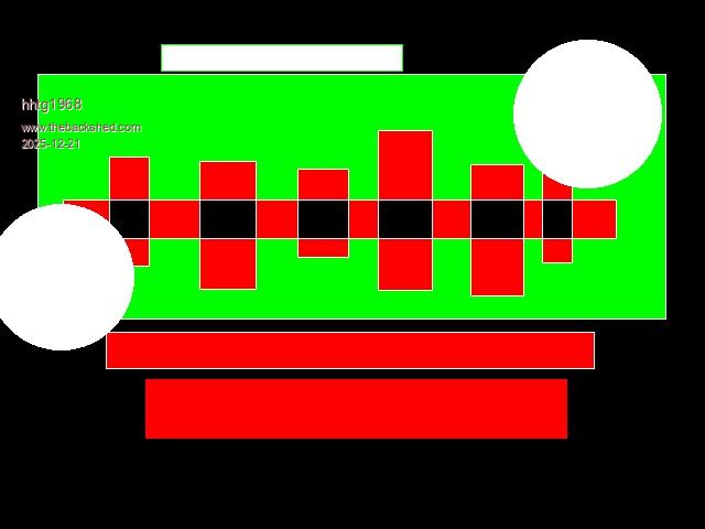

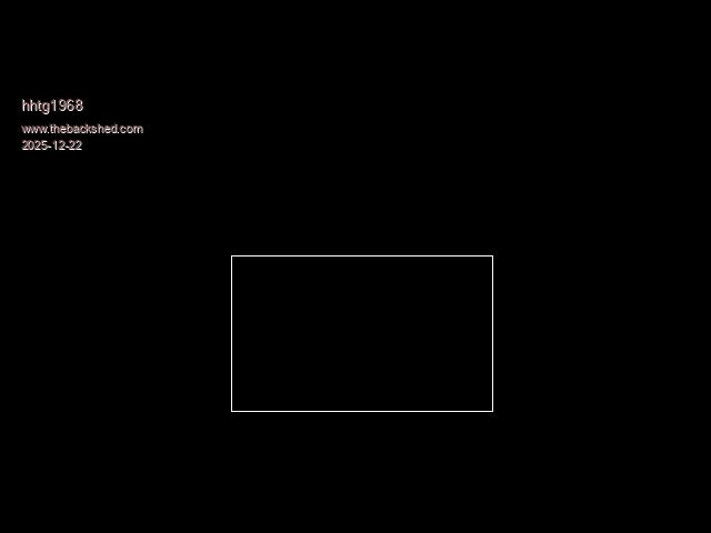

During the programming of the painting program, another effect occurs which I cannot explain.
I'm working in 12-bit mode. The painting is done on page 0, the preliminary graphics are on page 1. The menu is on page 2.
Menu page
Paint page
screen mistakes
In principle, everything works. However, in the lower third of the drawing area, the mouse cursor becomes patchy or disappears completely at times. With large graphics, errors appear on the screen (screen memory).
These screen errors cannot be cleared with cls, at least not at runtime. When I finish the program, the screen becomes correct again.
movies.zip
3 Movies (here you can see the mistakes at screen)
I only use predefined basic routines for the graphics, e.g., line, circle, box, etc. I don't write to the screen memory directly, as would be possible with "poke," for example.
Sometimes the screen errors persist even when I switch to the menu screen (page 2).
I didn't have this problem with an earlier version that wasn't 12-bit.
Perhaps someone has an idea.
