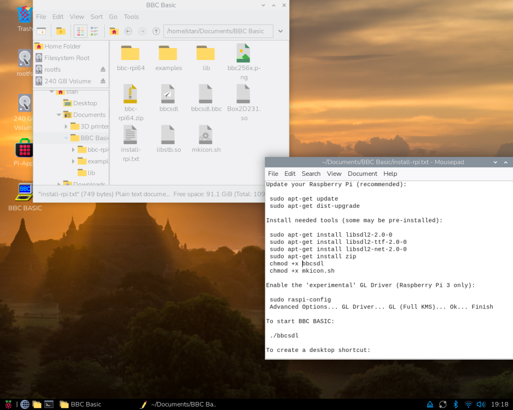

I tried to load BBC Basic on rpi 400 but the line chmod says file not found
Posted: 08:34pm 11 Dec 2025
You need to either fully qualify the path to the file you want to use chmod on, or switch to that directory.

I tried to the file home/stan/documents/BBC Basic, sane file not found . Linux is mew to me if on a a rpi it's debian so linux core. lots of fun
Posted: 10:28pm 11 Dec 2025
With a space between BBC and Basic, you probably need to put it in quotes.

on a terminal, run from inside the installation directory
chmod 755 bbcsdl
and try again ./bbcsdl
Posted: 12:45am 12 Dec 2025
  stanleyella said  I tried to the file home/stan/documents/BBC Basic
You also would need a slash before "home": chmod +x "/home/stan/documents/BBC Basic/bbcsdl".

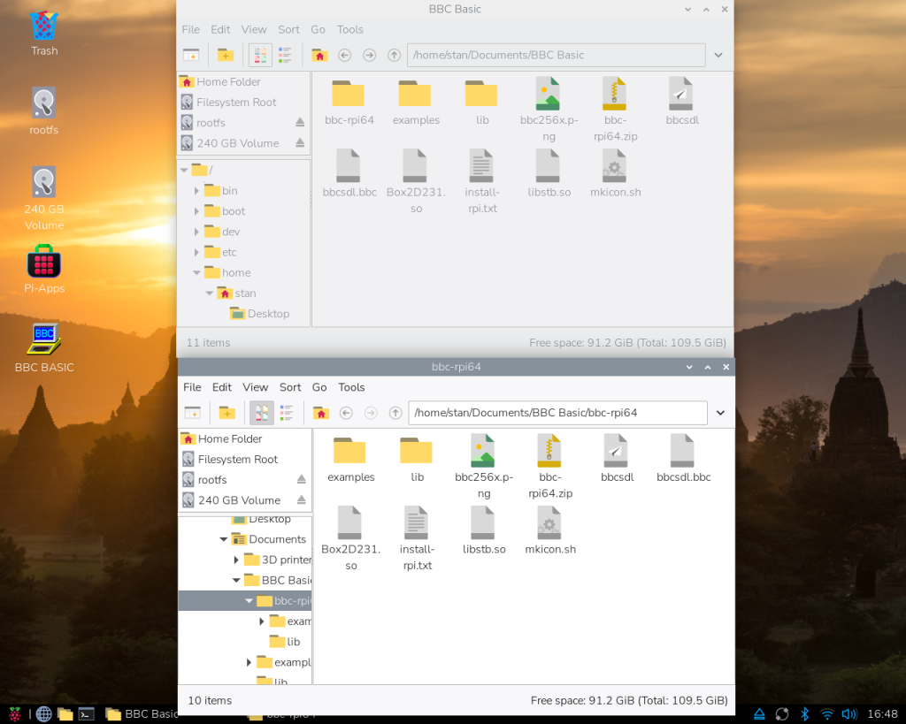

do I use the bbc 64bit folder which I opened and copied the install 64bit into?

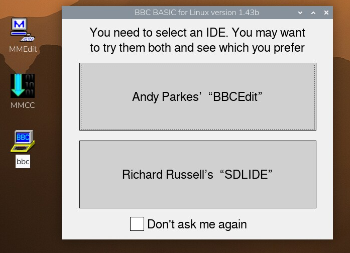

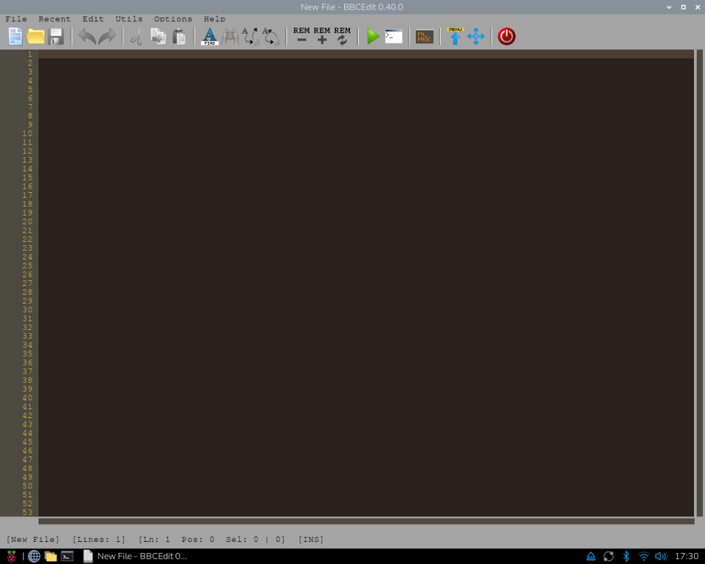

Posted: 05:32pm 12 Dec 2025
got this, what is it? The other ide is slide
Edited 2025-12-13 03:42 by stanleyella
Posted: 06:33pm 12 Dec 2025
Looks like an empty file, as it says, though it may have 1 blank line.
