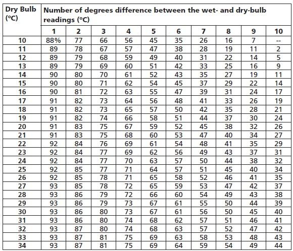

Can anyone point me to Psychrometric Tables, in table form not a graph, in Celcius. All I can find are tables in Fahrenheit. I asked AI and got all sorts of rubbish.

Posted: 02:42am 30 Nov 2025
Here is one I found . Only goes up to 40°C so you may have to extrapolate when it gets hot.
relative-humidity-table.zip
Posted: 02:50am 30 Nov 2025
This is one I found in '23
Using the formula I used back then, it would be easy enough to produce a table to cover your temperature range.
I will give it a go later when I have finished my 'real' jobs for the day.
palcal
Joined: 12/10/2011
Posts: 2054
Posted: 03:03am 30 Nov 2025
Thanks Jim, that's ok for now.
Posted: 04:06am 30 Nov 2025
Had a break from the shovel
rh1.pdf
3 different formula giving slightly different results
Was 45 degrees high enough?
palcal
Joined: 12/10/2011
Posts: 2054
Posted: 06:04am 30 Nov 2025
That's great Jim, it's just to test the readings I'm getting from Voltouts code. So far it looks good, been running all afternoon displayin RH at 1 minute intervals and seems accurate. Now to make up the hardware for the sensors, and the water to keep it topped up.
