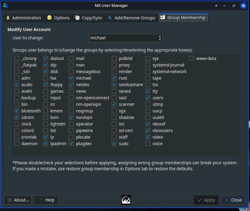

I couldn't understand all of that but for Linux chances are your user is missing permission to write (& read) the (USB?) port for the Arduino device - along the lines posted elsewhere.
You could test as root user (sudo etc) but easier just to set the permission.

What version of Arduino IDE are you downloading. I'm using the V2 Appimage from Arduino web site:
arduino-ide_2.3.6_Linux_64bit.AppImage.From https://www.arduino.cc/en/software/]
Arduino site has Appimage install info.
FYI: Linux MX-25 XFCE
Desktop: Xfce v: 4.20.1 tk: Gtk v: 3.24.48 wm: xfwm4 v: 4.20.0 with: xfce4-panel
tools: xfce4-screensaver vt: 7 dm: LightDM v: 1.32.0 Distro:
MX-25_Xfce_ahs_sysvinit_x64 Infinity Nov 9 2025 base: Debian GNU/Linux 13 (trixie)
Very low CPU and RAM usage.
Menu -> MX Tools -> User Manager -> Group Membership:

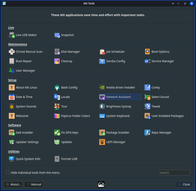

FYI: This is the MX tools available, there dozens of others, things like Timeshift etc are all there.

Hi Keepis I have the same version of the Arduino software and for a laugh just booted up the laptop and used your tips above so I could setup my username and saw that the dialout was already assigned so fired up the Arduino software and the nano connected straight away. I did have to change to the old programmer and for a laugh loaded the screen to to the nano and as the leds on the nano did flash it did program
