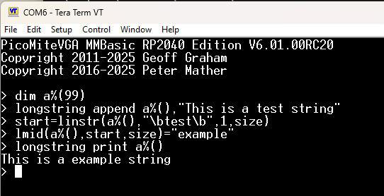

Attached re-worked C code and header for a comprehensive regular expression support for MMBasic. Support for this code will be in RC19 for the PicoMite when released. I'll leave it to Gerry to include in CMM2 and update the documentation.
re.zip
This includes pretty comprehensive support for groups other than Anchors inside groups. I've also added word boundary support \b and \B. Below is the test script for this functionality. For me on a RP2040 VGA version this passes all test 100%
' MMBasic Regular Expression Test Program
' Tests the INSTR() function with regex patterns (size parameter)
