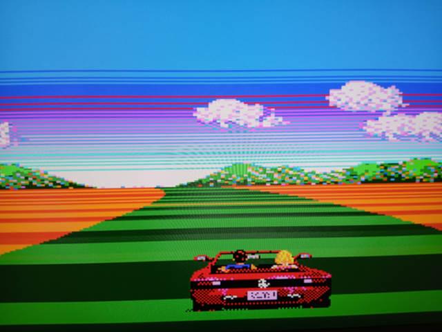

Hello everyone

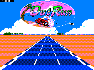

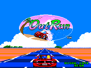

I'm trying to port to the CMM2 the great arcade game Outrun. It will be a challenge to make it run with good performance, this means, I will have a lot of fun
I can't promise that the port will be similar to the arcade version. I will try my best to keep it closest as possible to the original.
The following screenshot is the result of 300 lines of basic code from this weekend. The source code is not available in my git hub yet. I need to progress a little more before pushing it to its git repo.

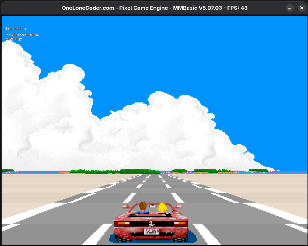

I pushed the Outrun's code to my github. It is far for be playable. For now, the code is only rendering the images to the screen and projecting the road to a pseudo 3D plane.
In my last commit I replaced the sprite write command by pure blit. It looks way faster then before. My goal is making the game to run at 30 FPS. I really don't know if it is possible. Let's see.

I use the same version of MMB4W as you 5.07.03b25, but strangely enough, the road is only displayed occasionally. Do you have any idea why that might be?
'no comment
LeoNicolas
Joined: 07/10/2020
Posts: 625
Posted: 10:18am 23 Nov 2025
Hi Martin
It is a bug in the MMB4W, see MMB4W: Framebuffer creation wiping out my global array
While the game does not have an exit key, to run the game, you need to:
1) First run: run"outrun"
2) Next runs: framebuffer close:run"outrun"
Thanks, that worked.
It looks very close to the original. Do you really want to scale the sprites in the game in real time? I imagine that would be computationally intensive.
 Martin
'no comment
LeoNicolas
Joined: 07/10/2020
Posts: 625
Posted: 06:41pm 23 Nov 2025
No, I will not. I will pre-render them in different sizes. There are a lot of challenges to overcome, while I'm trying to keep the frame rate in a descent range.

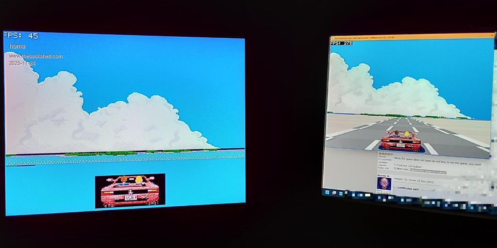

Posted: 09:26pm 23 Nov 2025
This is going to be challenging! In addition to low fps, there are also display issues on the cmm2.

Posted: 10:40pm 23 Nov 2025
Yep, it will. But for now, I'm not so concerned about running it on the CMM2. I can use a lot of tricks to improve performance, including reducing the resolution and maybe using CSUBs.

Here is an example of how the animation of the lines on the road can be done. I used my Pico graphics, but the program is for mmb4w (Only a few lines need to be changed for the Pico.). On the Pico, an animation frame takes about 4 ms to paint, so it is considerably faster under mmb4w.
Take a look at it when you have a chance.

They look great. We can improve a lot the render time reducing the screen resolution and also the size of the sprites we are bliting to the screen.
Edited 2025-11-28 06:28 by LeoNicolas
Martin H.
Joined: 04/06/2022
Posts: 1578
Posted: 07:34am 28 Nov 2025
Of course, reducing the resolution affects speed and memory requirements. In the example, I initially used the full 320 x 240 resolution. The original only has 320 × 224.
Reducing the playing area to, for example, 256 x 192 would save some 25% memory and computing time, but it would also change the appearance. To do this, it would be necessary to reduce all sprites/tiles to 0.8 times their original size in a way that looks believable.
