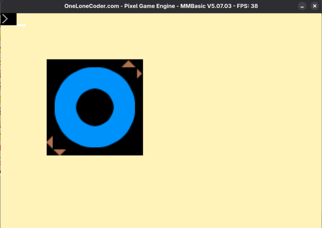

the result is:
The transparent areas from the PNG are copied as black by the blit command, overwriting the back image and background.

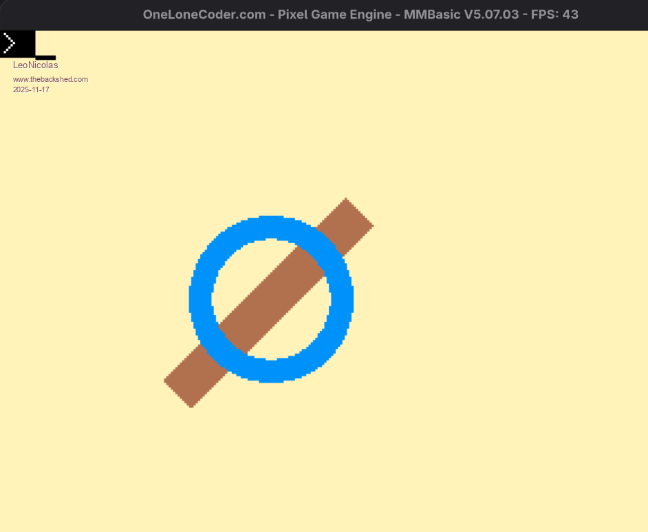

I found the solution. I can use the sprite write command to copy the pixels like a blit command, but respecting the transparency.
option explicit
page write 1: cls 0
page write 0: cls rgb(255, 243, 185)
mode 7,12,rgb(255, 243, 185) ' 320x240 / 12 bits
page write 2: cls 0
load png "test.png",,,0
sprite read 1,82,0,100,100,2
sprite read 2, 0,0,74,74,2
page write 0
sprite write 1,72,72
sprite write 2,84,82
And this is the result:

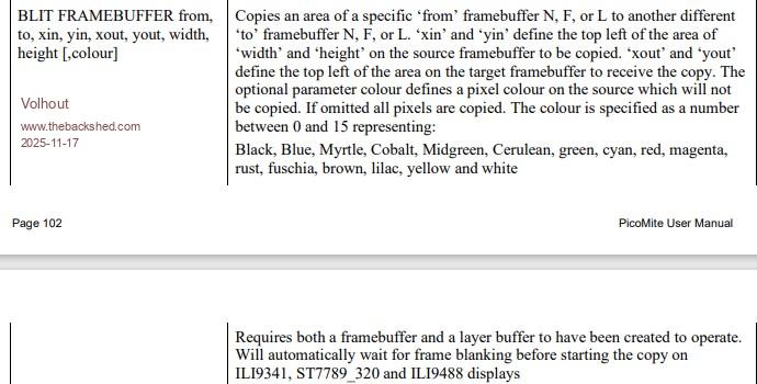

On picomite(VGA) there are typical only 2 layers. The N layer is on bottom, and has no transparency. The L layer is projected onto N, and knows 1 color of transparency.
Following BLIT commands are omitting the transparency color.

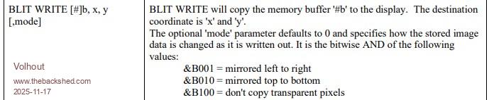

Look at the "orientation" parameter in the BLIT command.
Also, look for the "NOTBLACK" colour.
