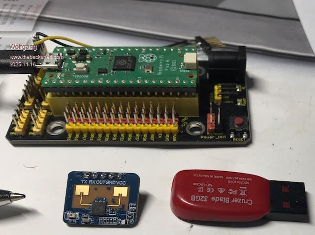

Posted: 10:07am 16 Nov 2025
@ville56
Thank you very much for this Pico programme. It is very impressive for me and thank you for your efforts in creating it. I can take a lot from it. The comments will help me to put the LD2450 into operation.
I have this version:

Wolfgang,
the radar on the photo is not a RD-03D or an requivalent  like my device as mentioned in the thread. So this uses a different protocol. Have to look it up, but the principle should be the same. Have you more Information about the type of your radar so I can make modification to the code accordingly?

Posted: 02:37pm 16 Nov 2025
@ville56
I found the Serial Protocol pdf again as a *.pdf file here. I didn't want to post my pdf here because of its length. I hope the link is still valid.
https://naylampmechatronics.com/img/cms/001080/Protocolo_comunicacion_serial_LD2410C.pdf
Thank you in advance for your effort and support. I really appreciate it.
Greets Wolfgang

Posted: 03:54pm 16 Nov 2025
Wolfgang,
the link works. The LD2410C is a different class of device, the protocol is a bit more complex and the documentation is as bad as it can be ... partially unclear and inconsistent. So I had to order one to dissect the protocol on a live part. Should arrive here end of next week.
For the beginning, the serial interface should run on 256000 Bd, a default frame should be 23 bytes long if I'm not wrong, and the header should be F4 F3 F2 F1. The rest of the data sent is, for me, more or less understandably described in the manual. But I didn't read every detail ...
The biggest difference to the LD2540 seems to be that there is is no coordinate information available from the LD2410 but distance only. Anyway, will have some experiments as soon as the part is here ... and I will tell you what I found out
73 de OE1HGA, Gerald
