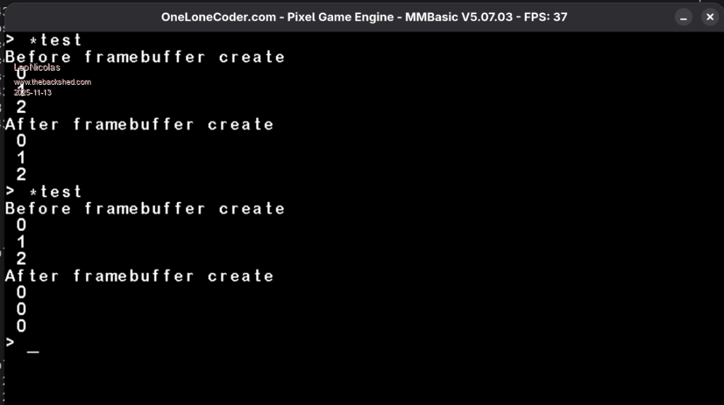

I've encountered an interesting problem. My global array g_values is being cleared after the framebuffer creation command. It runs with no issues on the first execution, but if I try to run it again, the global array is wiped out after the framebuffer creation. The problem does not happen if I use the framebuffer close instruction at the end of the program.
Off course this is a simple example. In a real app with a infinite do/loop, it is very common during development, to break the app with ctrl+c, which causes the program not cleaning open resources or closing the framebuffer, which triggers the issue.
Is this the expected behavior? Maybe is it happening with me because I'm running MMB4W on wine?
option explicit
option base 0
option angle degrees
option default float
dim g_values(10)=(0,1,2,3,4,5,6,7,8,9,10)
? "Before framebuffer create"
? g_values(0)
? g_values(1)
? g_values(2)
framebuffer create mm.hres, mm.vres
? "After framebuffer create"
? g_values(0)
? g_values(1)
? g_values(2)
Output:
Edited 2025-11-13 16:16 by LeoNicolas
