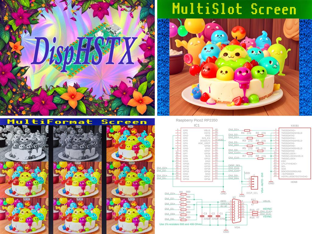

P.S. in 2350 you should also be able to use the HSTX block for VGA222, in stead of PIO's. There is code available for that. Not sure how mature though.

  Volhout said  P.S. in 2350 you should also be able to use the HSTX block for VGA222, in stead of PIO's. There is code available for that. Not sure how mature though.
https://www.breatharian.eu/hw/disphstx/index_en.html
