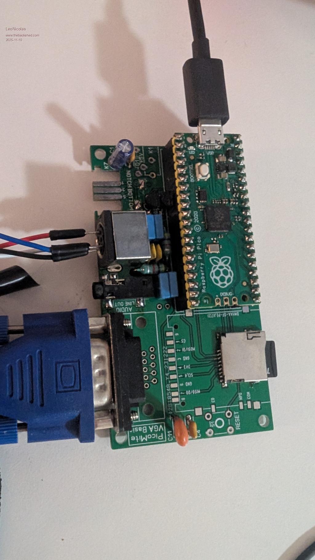

Hello
I have updated my PicoMiteVGA to the 6.00.03 firmeware (PicoMiteRP2040VGAV6.00.03.uf2). After the update I can't access the SDCard anymore. When I try to change to B:, it shows the following message:
Error: B: drive not enabled
The SDCard was working fine before the update.
Does anyone have an idea what could be the issue?
This is the photo of my board:

Type OPTION LIST
Is there an option sd card ?
Check if the option settings are the same as in the document that came with the unit. Maybe your current setting are mismatch of pins.

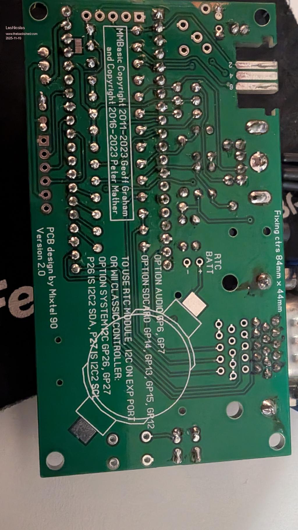

Never mind, it is written on the back of the board
Posts: 9328
Posted: 03:38pm 10 Nov 2025
I recognize that board from somewhere... :)

  Mixtel90 said  I recognize that board from somewhere... :)
Thank you very much for writing the command at the back of the board. It was super useful.
