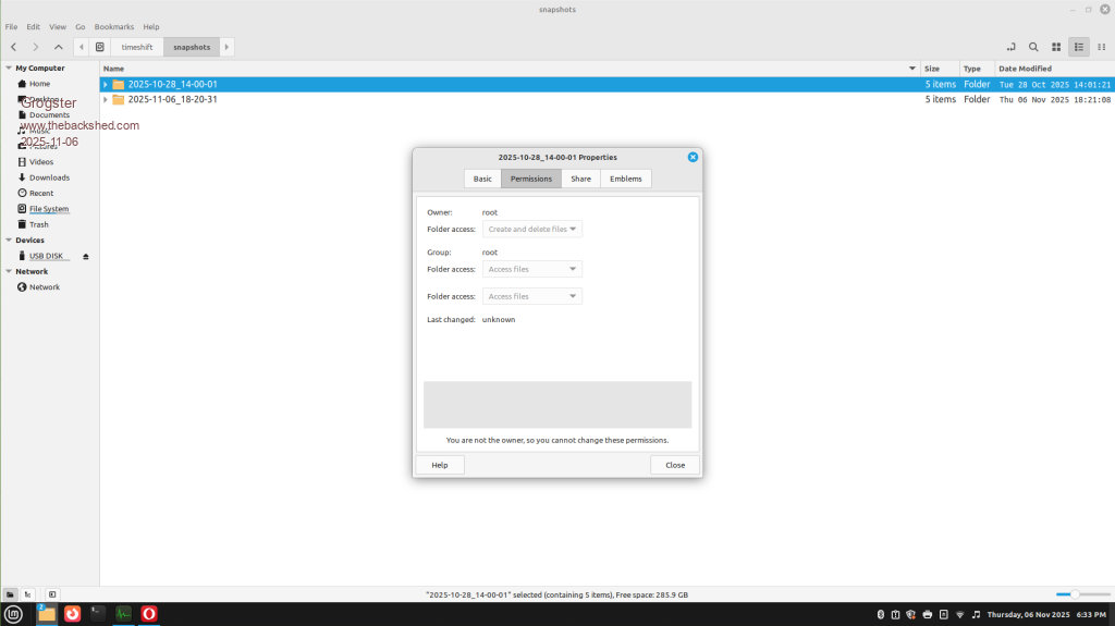

Timeshift in Mint is great, and I have a couple of them now, but I want to back these up to an external drive, in case the system SSD dies or something - rendering the Timeshift backups useless.
A simple copy/paste does NOT work, as Timeshift is running as root, and I am just a plain old user.
Permission to even READ this folder, is therefore, refused by the system: "You are not the owner, so you cannot change these permissions."
....but.....I am the ONLY user on this machine....
(but I am NOT root, so I suppose this is f-ing with things)
I expect I perhaps have to do some commands with the terminal to allow access for this.
Can anyone prod me in the right direction?

You can change the owner (user and/or group) and/or change access (e.g. to allow read/write by others).
You can do those for the directory (aka folder) and/or files in it.
Or, you could act as the root user to do (whatever commands you wish) e.g. using sudo.
Any feeling about which you'd like to do?

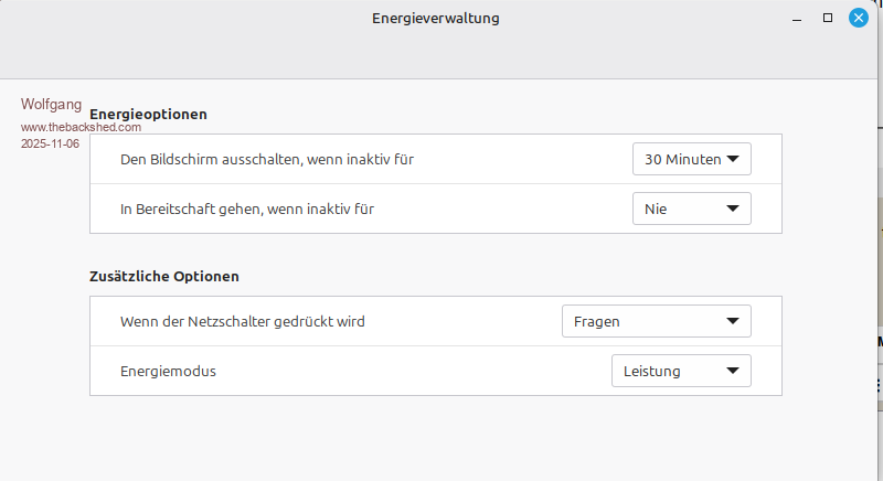

I'm going to add another but different question here:
My Linux Mint 22.2 runs perfectly on my NUC5i3RYH, except that sometimes Mint cannot connect to the Internet after waking up from standby mode.
As I said, it's not always, just sometimes.
Is there an explanation or solution for this?

In configuration, you can disable sleep mode / low power mode for WIFI. Then the CPU can fall asleep, but WIFI stays awake. This could help.
I have had similar on older linux years ago, on a laptop. It was (in the end) fixed by an update in the WIFI firmware (binary blob) on a Broadcom B43 WIFI chip.
On the laptop you could not leave WIFI awake, but on you NUC you could.

Timeshift uses a tricky mechanism, to do incremental backups with only needing extra space for the new data but the old not changed data is just a hardlink. That's why it's only possible to use ext4 or BTRFS (on a dedicated partition) on which it is possible to have hardlinks with the same inode.
I didn't research but if I would try to have a copy then I would copy the partition with a tool like clonezilla to the new location and after that resize the partition with Gparted.
Don't try to change the ownership nor the permissions, I think this would result in data loss. If you try to copy, then copy as administrator(root).
I wouldn't do that at all.
I would install Mint on the new external ssd and use let's say 100GB for system.
The rest or a part of the remaining space I would setup a new dedicated Timeshift partition and do a new base snapshot.
Or you can even restore a snapshot to the ssd so you have a clone of your actual system and then resize the root partition to 100GB
Then you can boot every PC you like with this ssd plus you have your environment you are used to.

Try to disable the power saving settings in the BIOS.
But your problem is known and happens with some mainboards while others work..

I have only a LAN connection to my Router. Wifi I don't see in my configuration.
In "Systemeinstellungen/Zusätzliche Optionen" there is only an "Energiemodus", which  I set now for trial to "Leistung"
Let's see what effect this has.

Thanks for your suggestion,
my change to the mode "Leistung" was not the solution.
I think the NUC-Bios may causing this artefact? it is an older one.

  Quote  EDIT: I would still like to know how to change the permissions of the Timeshift folders on the system SSD, so I can copy these to a dedicated USB SSD I am planning to use for this purpose.
In general: If you're logged in with as user, even though this user is administrator, you can only handle files where this user is the owner and/or has permissions to read/write. For all other changes you have to be root and thus need sudo to do this

  Grogster said  EDIT: I would still like to know how to change the permissions of the Timeshift folders on the system SSD, so I can copy these to a dedicated USB SSD I am planning to use for this purpose.
You can copy them without such change.  You can either be the Timeshift user (if there is one?) or root to do it.
Or, you can use chown but Timeshift may not like it, depending on how it checks (if it does) for unexpected stuff.
