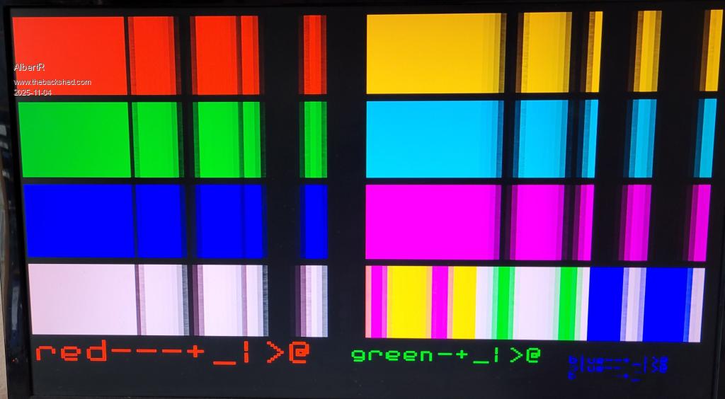

Hallo Peter,
very nice. Your program inspired me to change a few things about my PIOs. Thank you for that.
I don't know anything about VGA, but since the color signals are analog, some kind of “PWM” should work to reduce the number of RGB-pins.
I changed the output part of PIO 1

The output is shown here. If both bits of an color are set it is ok, but it not I got a kind of of floating in the printposition. It looks like a diff of 5 pixel, that means one "pull". Could there be a lack of synchronization here?
output of:

Posts: 6253
Posted: 02:45pm 04 Nov 2025
@Albert,
On a CRT that might work. Although the trace written will have traveled a bit between the 2 OUT's, in essence you are creating a 1280x480 (not exactly, it is only 1280 when you have the times identical).
But for LCD this will most likely not work. That LCD has an ADC that samples the video. There are 2 options:
1/ The ADC detects 1280 since there are more transitions than 640. But it can not do 1280x480 since that is not a known format, so t will not sync.

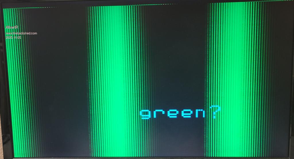

@Volhout,
that makes sense. The ADC only samples at his samplepoint. There doesn't seem to be any filtering in the tft.
My test results:
to 1. the ADC detects only the 640x480(info in tft-menue)
to 2. the samplepoint is not exact in the middle of the pixel, it moves, see picture.
The background has the color RGB222(0,1,0)
Finally it was only an idea.
