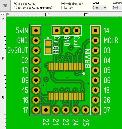

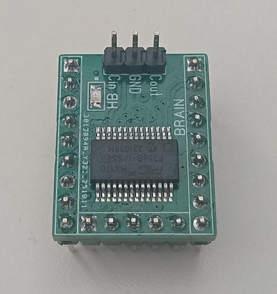

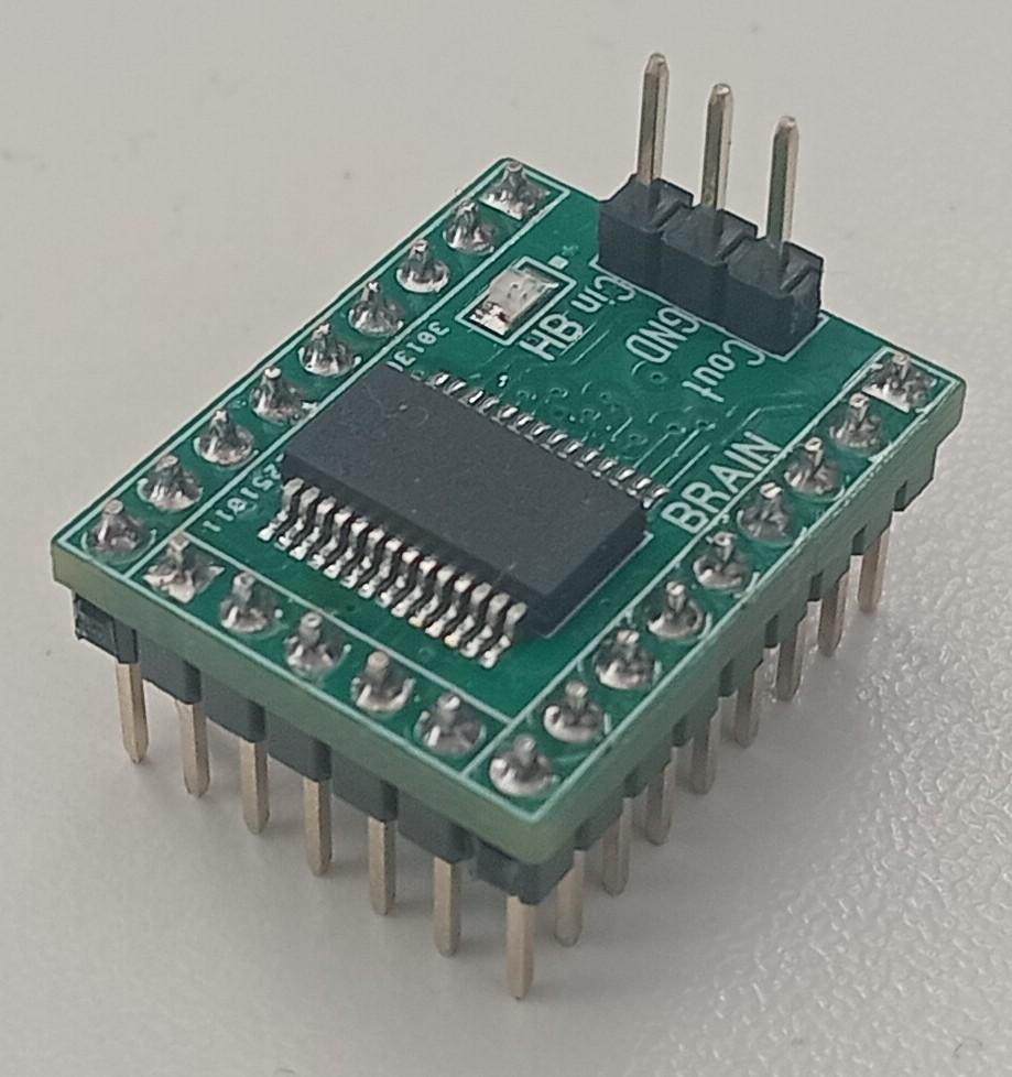

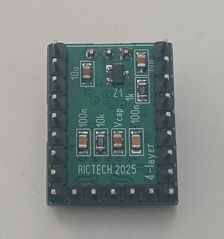

Hello everyone.
Following on from my other thread about Watchdog problems when using the WS Zero module and the PM firmware, I hereby show-off my version of this module.
The footprint is exactly the same, but the I/O numbers are different.
This new design is based on the classic MM2 chip, that being the PIC32MX170F256B, and is programmed and used in exactly the same way.
Certain I/O pins on the 170, needed to be on certain pins on the footprint, which is why the pin numbers are a bit all over the place. This board is 4-layer.  Not possible to do on two layer with the size restriction.
See my other thread for reasons as to why this came about.
I will be getting a few of these made, so if anyone is interested....

The price on 4-layer is very cheap now.
Not what it used to be.
I'll look it up tomorrow, but it was so insignificant, I never even questioned it as part of the order.
Posts: 10104
Posted: 12:21am 25 Oct 2025
Just for the thread's information, 10pcs of this 4-layer PCB was US$7.20, so 72c per board - VERY cheap.
Naturally, gets more expensive the bigger the board, but the CMM2G2v2 board is 4-layer, and 10pc of that size in 4-layer is still only US$37.60 last time I ordered some(August 2025), so only US$3.76 per 4-layer PCB.  This is just the PCB, not counting any of the components on the CMM2G2v2, but it just lets you see how cheap 4-layer has become.
I agree - 4-layer DID used to be startlingly expensive, but it isn't now.
Even moderately large sized PCB's are very cheap.
It's the 6-layer and 8-layer PCB's that are now hideously expensive.

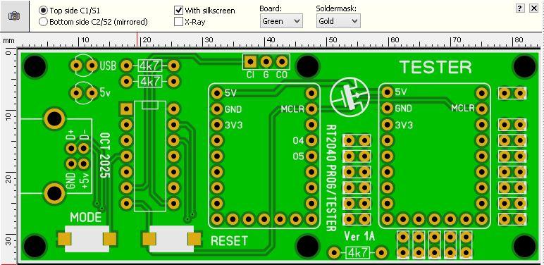

Programmer/Tester PCB:
Posts: 10104

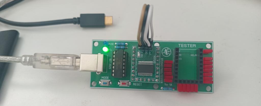

Posted: 04:59am 31 Oct 2025
Programmer assembled and working.
I just need to write a little test code, for the TESTER side of the PCB.
The idea being, that you program the module as a first step, and then move the module to the TESTER socket, and run the test code, which just steps through all the I/O pins, that each have an LED on them.
I am using one single resistor for the LED's, cos I plan to sequence them as the test, so only one will "ON" at any one time.
