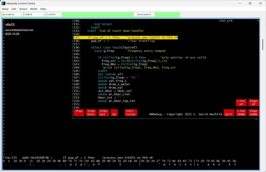

If I use the page up/dn key, I get some lines at the bottom of the screen. Is this something new?
73 de OE1HGA, Gerald
EDNEDN
Joined: 18/02/2023
Posts: 309
Posted: 01:04pm 29 Oct 2025
Yikes!!!   That is some debug code to show the tokenized MMBasic program and where the interpreter is 'Executing'.    The first vertical bar is the pointer to the line being 'Executed'.
You can toggle that being active by pressing the ~ key.
I don't know how you found that, but I'll get that fixed and re-released ASAP.
@ville56    The timing of USB Serial characters has changed significantly.   If (from the command prompt) you type > EDIT it will bring up the full screen editor.   And the Page-Up and Page-Down buttons are not working there either.   Somehow the Page-Up and Page-Down keys (which include ~ in their sequence are not getting interpreted correctly).
The Red Menu items at the bottom of the MMDebug screen have Page-Up and Page-Down.   Those do work correctly.    You can use those until I figure out what needs to be done.
Edited 2025-10-29 23:20 by EDNEDN

must have been a pg up/dn escape sequence then ... at least I can switch the debug lines on with it, reliably.
