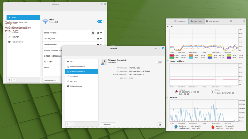

Here is a snapshot of the issue...
With Ethernet disabled, everything is fine.
ENABLE it, and BOTH the WiFi and the Ethernet stop working.
Might post about this on the Mint forums also, cos this does seem very odd...

  Quote  I'm guessing about intentions, but that might be what almost everyone would want and expect.
Yes, I think you - and Mick - are correct.  It's just I am trying to access two networks at once from one machine.
