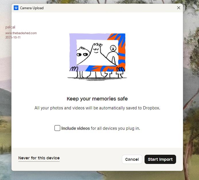

When I hold down the boot button , insert RP2040 then release the button I get this
instead of the normal upload screen, any one know how to fix.
Posted: 02:46am 11 Oct 2025
Try clicking on "Never for this device"
Then use the normal file manager

this is DROPBOX recognizing a new USB device and wanting to include it in its ecosystem. Just click "never for this device"
As Dropbox is recognizing the device, Windows Explorer or any other file system application will also see it as an additional drive letter. Open this new drive letter to copy a .uf2 file over to this new drive letter.

OK that worked thanks Jim,Barry.
