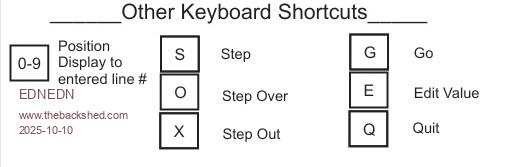

That is a good idea.    In the meantime, if you load up the 10 Minute Tutorial it will let a person see all of the important features the debugger provides as it steps through the sample program.
And the 'Cheat Sheet' does let a person see what it looks like and how to do various things within the debugger.

2/ After I tried modifying a variable value, it was not obvious how to exit the window.
  ... until I simply clicked outside the variable edit window.
The planned and designed method to close out and leave the 'Edit Value' command box is to
give it an 'Enter' key with nothing else at the command prompt.   Depending on what
happened with the last command that was given, that can be a single 'Enter' or it might be
three 'Enter' keys in a row.
I understand that is a little cryptic at first.  But I am open to suggestions and once
a person gets trained to just hit a blank 'Enter' command it is pretty quick and natural.
Perhaps making a Mouse Click anywhere outside the 'Edit Value' box to 'unfocus' and remove
the box is the right way to handle that?    Or perhaps, recognizing either a blank 'Enter'
or Mouse Click outside the box would make more sense?
I'm more than willing to alter this behaviour.   Let's get some more discussion and figure
out what the community gravitates towards as the 'answer'.

2/ I like closing the variable edit window with mouse click. I only did not know until I tried.
OK.  I'll figure out how to make that 'official' and always cleanly exit the window.

  AlbertR said
You already evaluate keys for changing the width and height, maybe you could also add a key for “step”. With the mouse, I think you have to concentrate more on hitting the button, but with the key, you can just leave your finger over it.
Ultimately, we probably need a full manual.  But in the 'Cheat Sheet' it says:
