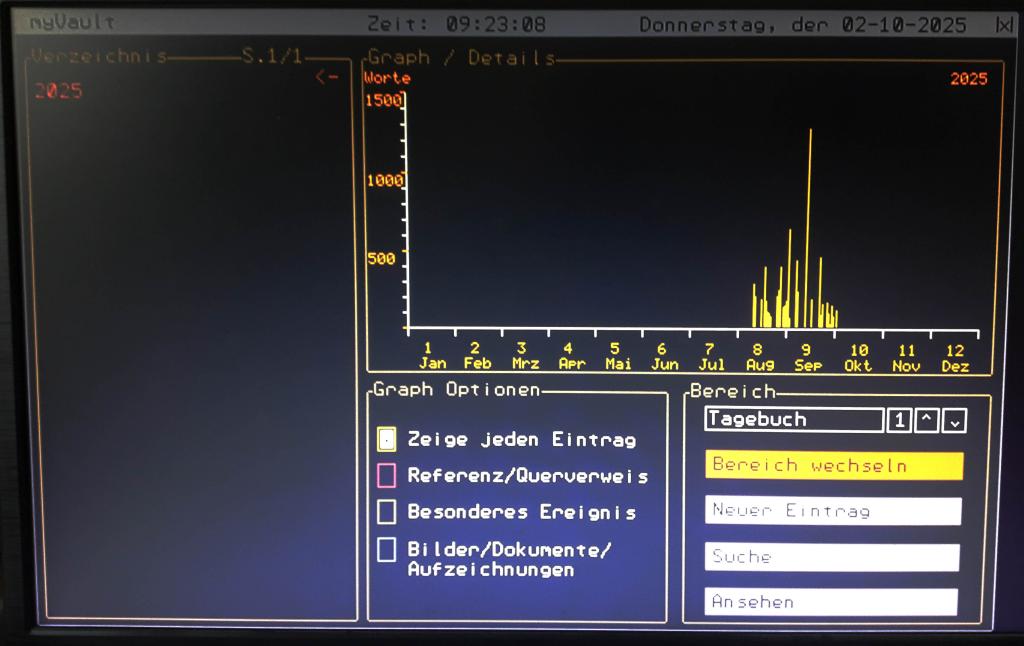

I am heavily working on the translation of my journal/diary program including GUIs for the PicoMite HDMI (USB!) version, because I started this project in pure German.
The Problem: I was using the PicoMite HDMI PS/2 version, in this version I am able to

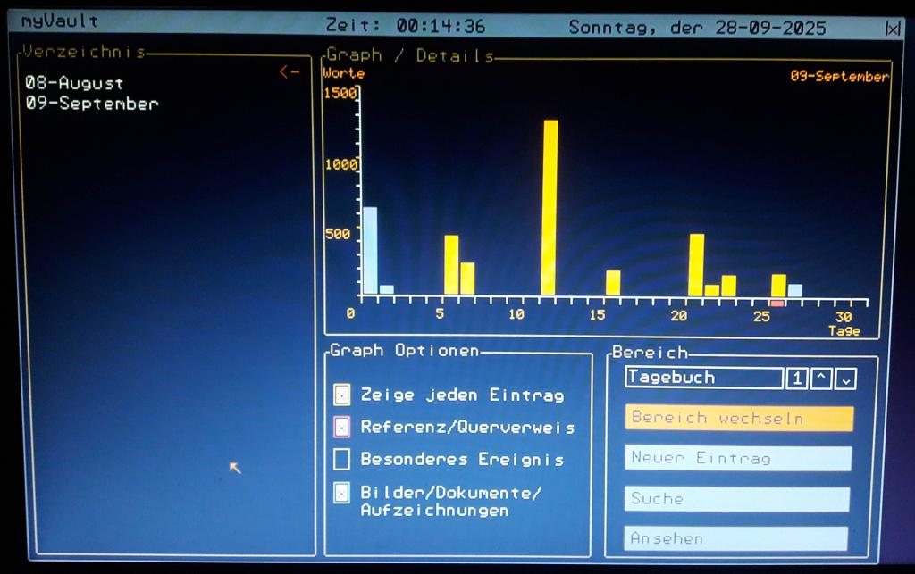

Only for the interested, a short program description:
Here are some images of the already finished (german version) of my diary/journaling
software, it also includes a text editor, excessive graph options to show different parameters. And it doesn't stop there: you have in fact three different working areas:
diary/journal = German = "Tagebuch"
health        = German = "Gesundheit"
notebook      = German = "Notizbuch"
in every area (German = "Bereich") you have different visualisation parameters for the graph. For example you can track your: pulse, blood pressure, stress, words you have written on the specific entry, and you can even add own comparison parameters.
There is a search function, which allows to search a whole month for specific words.
The program is split into six different (chained) programs.

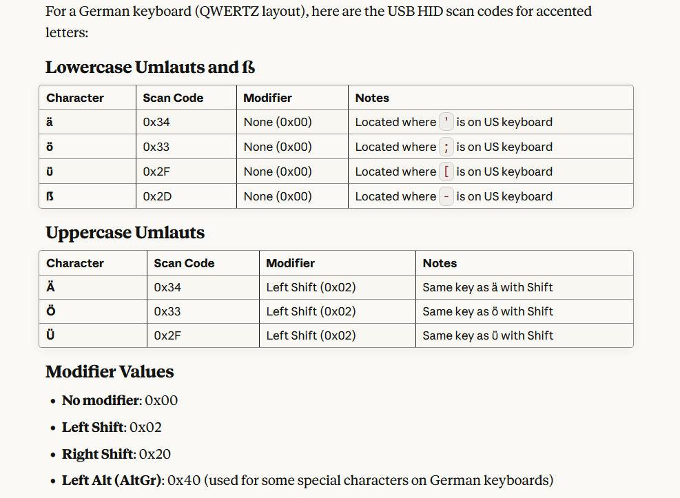

with this version I can indeed catch the "Umlaute" keys but the command
MM.USB
behaves different compared to "MM.Info(PS2)".
MM.USB always shows the last pressed key, MM.Info(PS2) in contrast "resets" the key value.
The problem now is, when using:
MM.USB (to detect the ÄäÜüÖöß) I also have to use KEYDOWN(7) for detecting the shift modifier.
But if I use both in combination, there is a huge latency and missing keypresses again.

The solution (or at least part of it) is your new function MM.USB, only here I have the chance to "catch" any output from the mentioned keys.
So my only chance is to do the following:
1. read the raw key (ä,ö,ü,ß) via MM.USB
2. check via keyDown(7) if SHIFT-key is pressed
3. manually map the "ä,ö,ü,ß / Ä, Ü, Ö, ?" to a custom FONT, which Martin kindly created
Problem: as soon as I use "keyDown(7)" everything is "laggy", keypresses are skipped or ignored.

If you provide a list of the USB scan codes for all relevant keys and required modifiers associated I will see if I can do anything. I just need all the required unique pairings I don't care what they mean
e.g.
code modifier
0x87  ALT
0x87  none
Posts: 12176
Posted: 10:48am 03 Oct 2025
Is this correct
Amnesie
Joined: 30/06/2020
Posts: 763
Posted: 07:57pm 03 Oct 2025
Hi Peter,
Sorry for my late respond, just came home.
Yes your list is correct. For example, If I type in your test-firmware via:
Print MM.USB (and pressing "ü")
I get: 47, which is "0x2F"
Etc...
Would be Amazing , if you could work something out for a simple solution or some function which acts like MM.info(ps2)
If you need some more testings or info, I will do my best.
Greetings
Daniel
